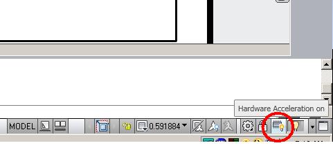

Tiger Posted May 26, 2011 Posted May 26, 2011 Hi guys, I have been annoyed with the color of my crosshair for a while, I have my background set to black so the the crosshair is white. This is no problem in Model and over the paper in Layout, but when I move the crosshair outside the paper to the Grey area, I can't see the crosshair. I can't remember this being a problem before so it must be something with 2011 that I installed a while back. I can find where I change the color of the crosshair (Options > Display > Colors > Crosshair) so thats not the trouble. The trouble is that since I can't remember this being a trouble before, the crosshair must have changed color from White when black background to Black when white background. And I seem to remember that there was a color before that was called Black/White that was this exactly. It changed from Black to White depending on the background - but I can't find that option any more! Is it somewhere? Or has it gone way of the dodo? Quote

nestly Posted May 27, 2011 Posted May 27, 2011 Hardware acceleration on or off? I have machines with both Quadro and FirePro cards, and with a "black" background and "white" crosshairs , the crosshairs remain "white" on the grey paperspace background when hardware acceleration is turned on, but they do switch to black on the grey paperspace background when hardware acceleration is turned off. Quote
Tiger Posted May 27, 2011 Author Posted May 27, 2011 Huh..no idea actually, but would that change automatically when I plug in an external monitor? Quote
nestly Posted May 27, 2011 Posted May 27, 2011 Hardware acceleration could definitely turn off by un-plugging an external monitor, but I doubt it would re-enable itself automatically when reconnecting it. You can toggle it on/off and access the settings, logs, and driver details by clicking on the "computer chip" icon in your status bar. Quote
Tiger Posted May 27, 2011 Author Posted May 27, 2011 Ok, I can see that its Off right now (when the color-change is happening as I want it too) - I'll make a note to check it on monday to see if it turns on when I connect the external monitors. Thanks for the tip Nestly Quote
