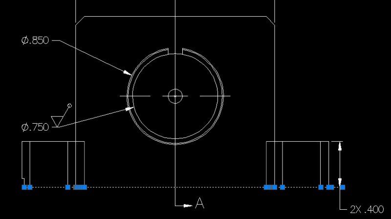

There was a considerable difference in how it converted the lines in the drawing. If you look at the view at the bottom of the page in Tank's drawing, his converter did that line along the bottom of what I'd call the front view in several segments. See below:

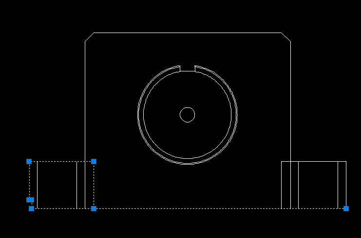

That's ok, the segments run from the endpoint of one vertical line to the other. At least that's predictable and easy to fix. Mine did it wierd:
Why it decided to make those particular segments into one polyline, I don't know.
