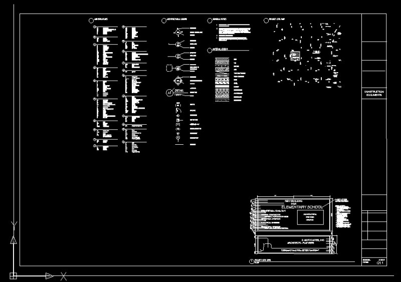

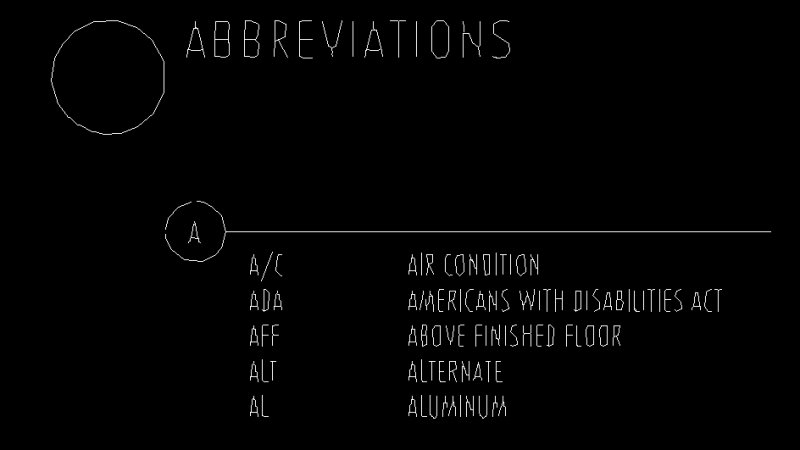

Jack_O'neill Posted November 17, 2011 Posted November 17, 2011 Here are the results I get with "any pdf to dwg" converter. I used the free trial, it's $180 to buy the thing. I had to post a screen shot because even zipped this file is over 1mb in size. It has 2 layers. I did an erase all just to get it to count. There are 13,851 objects in this drawing after I removed all the identifying bits in the titleblock to protect the architects, engineers and my customer. The results are completely unacceptable, and a good portion of it is unreadable. I do not know how the pdf was created, it was sent to me by the customer. This should be a 50-100K file, but it's almost 1.5 mb in its unzipped state, and thats after I erased the other information. Just that removed over 9000 objects. This is the 4th or 5th one of these converters I've tried in the last year, all with similar results. They've ranged from this one's price to freeware, and none of them have created a file that anyone could use. This is why I redraw when customers send me jpgs, tiffs or pdfs. Files like this are a complete waste of time and effort. I realize that it depends on what and how the pdf was created, but I don't have the luxury of deciding that. I get this stuff from contractors most of the time, who scan a copy of a copy of a copy at 300 dpi because I asked for "electronic drawings" and he thinks that's what I mean. Occasionally, there won't be enough dimensions or other information to recreate the drawing. In those instances, I bring it in as an underlay and draw on top of it. I can do that in half the time it takes to create and then fix stuff like this. Quote

rkmcswain Posted November 17, 2011 Posted November 17, 2011 Quote Here are the results I get with "any pdf to dwg".... Based on your screen shots, it looks like this was either a scan or the text was converted to raster somehow in the PDF. The PDF->DWG process honors the old saying "Garbage in, garbage out". As Tankman mentioned, if it was a PDF plot straight out of AutoCAD, the results would be pretty good. But if the PDF is a scan, and you need vector (as opposed to just a background image), then as you have figured out - you might as well redraw. If you can send me the PDF, I would like to try myself. Quote

Jack_O'neill Posted November 17, 2011 Posted November 17, 2011 rkmcswain said: Based on your screen shots, it looks like this was either a scan or the text was converted to raster somehow in the PDF. The PDF->DWG process honors the old saying "Garbage in, garbage out". As Tankman mentioned, if it was a PDF plot straight out of AutoCAD, the results would be pretty good. But if the PDF is a scan, and you need vector (as opposed to just a background image), then as you have figured out - you might as well redraw. If you can send me the PDF, I would like to try myself. It probably was a scan, and a low quality one at that. I don't know as I got the pdf in an email. It looks pretty good on screen, and prints well. The "any pdf to dwg" advertising package said it would reliably convert pdf's from any source directly to dwg (hence its name). I just thought it amazing that it originally had more than 22,000 objects after the conversion. What should have been 75k or so was over 1.5mb. I'd send it to you, but I'm contractually obligated not to release it to anyone which is why I removed any identifying text from the screen shot. Quote

rkmcswain Posted November 18, 2011 Posted November 18, 2011 Jack_O said: ...I just thought it amazing that it originally had more than 22' date='000 objects after the conversion. What should have been 75k or so was over 1.5mb.[/quote'] The way I understand it, if it was a scan, or created using a poor PDF creation program.... to represent a letter "A" for example, instead of storing a single font character, it might have been represented as three lines. A letter "O" might be represented as 20 lines, a large arc in the drawing could be hundreds of lines, and so on. It doesn't take long to add up. Jack_O said: I'd send it to you' date=' but I'm contractually obligated not to release it to anyone which is why I removed any identifying text from the screen shot.[/quote'] No problem, understood. Quote
