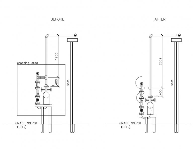

line2draw Posted May 24, 2011 Share Posted May 24, 2011 I am trying to strech a group or items and in the group is an arc. When I try to strech all at once, the arc does not move to the new streched position. Part of it stays in place and causes the arc to change size. Is this a bug or a toggle? Quote Link to comment Share on other sites More sharing options...
SLW210 Posted May 24, 2011 Share Posted May 24, 2011 You need to get all of the ARC in the crossing window. Quote Link to comment Share on other sites More sharing options...
line2draw Posted May 24, 2011 Author Share Posted May 24, 2011 You need to get all of the ARC in the crossing window. I have everything in the crossing. Quote Link to comment Share on other sites More sharing options...
SLW210 Posted May 24, 2011 Share Posted May 24, 2011 You need to post the drawing. Does _PICKFIRST = 1? Quote Link to comment Share on other sites More sharing options...
line2draw Posted May 24, 2011 Author Share Posted May 24, 2011 You need to post the drawing. Does _PICKFIRST = 1? ARC PROBLEM.pdf Quote Link to comment Share on other sites More sharing options...
