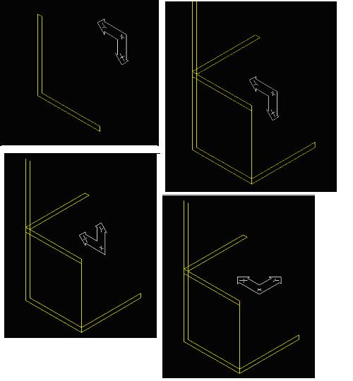

HI, I'm trying to follow a tutorial that basically is having me draw a 3D L-bracket. I start by outlining an 'L' shape. Then the tutorial says to do the following:
1. chprop
2. select all 6 sides of the 'L'
3. t (to select line thickness)
4. 175 mm
So, this is all fine and dandy, it's not rocket science. For some reason, though, some of the lines on my 'L' are extending in the +Z direction and some are extending in a different direction (could be X or Y, it does the same thing if I change the direction). So the resulting shape is definitely not an 'L' bracket. Can anyone tell me why don't all the lines extend in the same direction?
Thanks,
Dan
This effect seems to be independent of the direction of the UCS. I've attached a jpeg for more details. Here I have four pictures. The first is my original L shaped object. The following three is the result from a chprop / select all objects / line thickness / 150. As you can see, each of the three pictures has a different UCS but the result is the same. I don't understand why this is happening....any help would be greatly appreciated.
Thickness is being applied in the direction of "Z". You've got to be careful with the orientation in which an object is drawn and the direction in which thickness is applied. Did you change the orientation of your UCS between the time you drew the object and the time you applied a thickness to it?

ReMark, I definitely changed the UCS orientation between drawing the object and adding thickness. However, it's just six lines, I thought that when a thickness is added, it doesn't matter what the UCS was when the object was drawn, only what it currently is, and all lines will extend into the Z direction. I am a very beginner, though, this understanding may be flawed. As for the goal of this to be a solid or "look down the L", I don't know, I'm just following tutorial directions. I haven't even reached the point where a wire framed figure begins to have "solid" walls that you can't see through. I really want to understand this line thickness function, though, as it seems like it will be very important in adding a third dimension to my drawings.

ReMark, I found out it was a UCS problem. I tried starting all over and keeping the UCS constant while drawing the 'L' and applying a line thickness. This resulted in what I wanted, basically an L-bracket shape. I'm still confused, though, as I don't see why the UCS setting DURING the drawing of the lines should affect the line thickness command. I would think only the UCS setting during the line thickness command should matter. Anyways, thanks for the advice.
The line you're drawing will have thickness applied to it depending on the direction of the Z axis at the time the line is drawn. If you drew four lines and changed the location of the Z axis each time, when you applied thickness the lines would go in four different directions.
