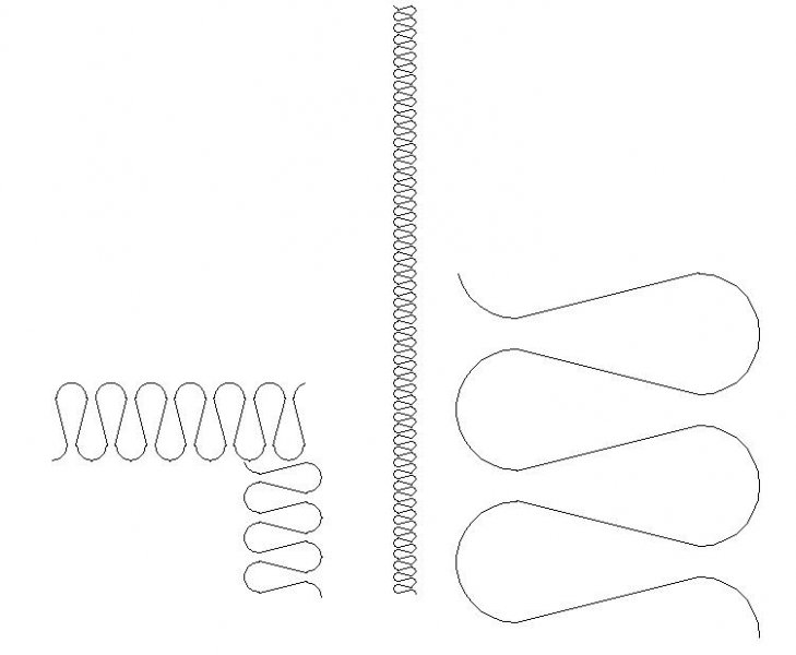

tennis4you Posted May 22, 2011 Posted May 22, 2011 I am having (2) issues with batt insultation. 1. When it is at a LTSCALE that looks perfect all other lines look awful. 2. I would like to have (2) different thicknesses of batt insulation in the same drawing, can I do that? Thanks! Quote
eldon Posted May 22, 2011 Posted May 22, 2011 As well as the LTSCALE which is a global setting, you can set ltscale for individual lines in their properties which overwrites the global setting. Quote
tzframpton Posted May 22, 2011 Posted May 22, 2011 Adjust the object linetype scale itself instead of the global linetype scale parameter. Do this by selecting the line then via the Properties palette. Quote
danellis Posted May 22, 2011 Posted May 22, 2011 When working in metric I've found that setting the insulation objects LTSCALE to about the thickness of the desired insulation (so 100mm insulation would need an LTSCALE of 0.1) generally produces good results (this assumes PSLTSCALE=0). I've never worked in imperial, but this might be a good starting value. dJE Quote

Jack_O'neill Posted May 24, 2011 Posted May 24, 2011 I use a lisp for batt insulation. I pick where I want it to start, where I want it to stop, and how wide and it pops it in there for me. No screwing around with linetypes and scales and all that. Three mouse picks and your done. Quote
irneb Posted May 24, 2011 Posted May 24, 2011 I use a lisp for batt insulation. I pick where I want it to start' date=' where I want it to stop, and how wide and it pops it in there for me. No screwing around with linetypes and scales and all that. Three mouse picks and your done.[/quote']Does that include curved batting? I know I've seen some be capable of doing curves as well, and making corners a bit neater than just normal batting linetypes. This is usually where the lisp type is better than the dynamic block, otherwise they're much of a muchness (even similar to use). Where the DB batting beats the lisp is it's editable. If the lisp batting needs to change you have to re-do it. The DB is a simple click & drag. Quote
Jack_O'neill Posted May 24, 2011 Posted May 24, 2011 No, this one won't bend around a curve or corners. It's just start, stop and width in a straight line. All of these were drawn with the same routine. You can either enter coordinates with keyboard or mouse picks for start and stop, and enter or pick the distance for the width. It draws on whatever layer and linetype are current when you start the routine. Quote
