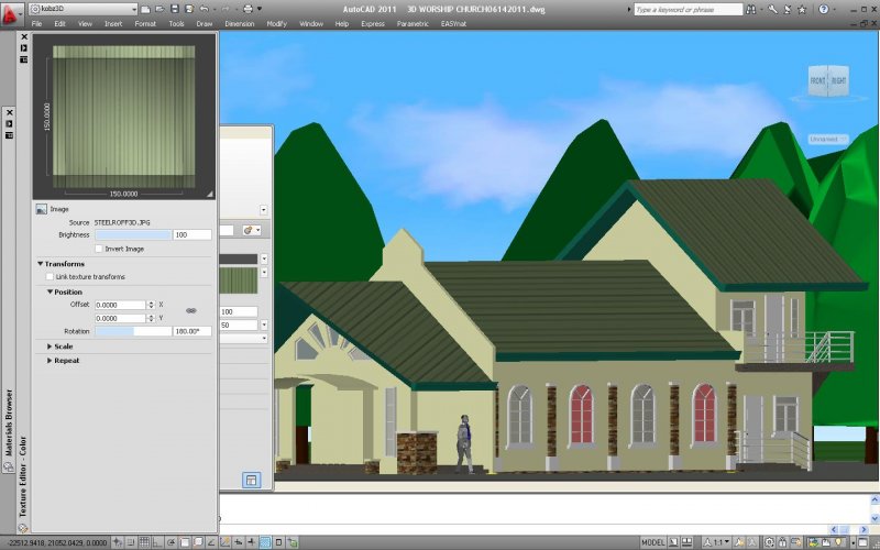

Rewind23 Posted June 14, 2011 Author Posted June 14, 2011 Hi there.. im still pursuing the rendering of my 3d model...but currently having some problem with my texture mapping....i attached a photo so you can easily analyze how i am doing this 3d model..the problem is: When i rotate the render materials(roof) it didnt rotate accordingly, they rotate with different angle, what i wanted to happen is ofcourse to give it a uniform angle if you notice the three portion of the roof has awkwardly rotate in 3 different angles...take note: i exploded the 3d roof...so its now in planar...what should i do?please help..thanks in advance! Quote
Rewind23 Posted June 14, 2011 Author Posted June 14, 2011 whew...! with some patience i re-read the tutorial and i was able to figure it out..PLANAR MAPPING solve my problem... will post the rendered model once finished.. Quote

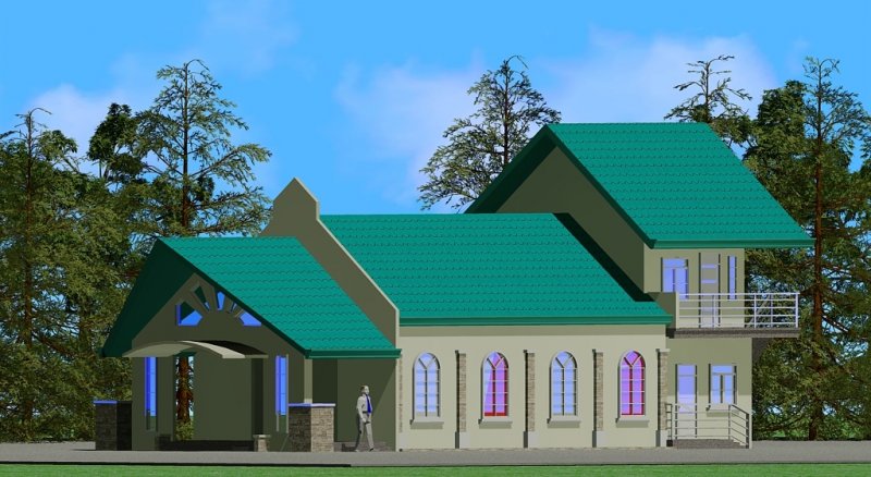

Rewind23 Posted July 18, 2011 Author Posted July 18, 2011 Hi there, its been long time since the last time i updated my thread due to some work load in the office And now i have the development of my 3d model..please check it out...not that good and its not yet final thanks to those who helped its highly appreciated...more power to all members and moderators.keep it up! regards Quote
Raudel Solis Posted July 18, 2011 Posted July 18, 2011 oh uhm .. unless the land is flat for miles on end why is the horizon so low?? look in the lower right area around the tree? its still sky there. Quote
Rewind23 Posted July 23, 2011 Author Posted July 23, 2011 @raudel- yeah i think i need to fix that..thanks for that comment...it helps me improve my 3d work... Quote
