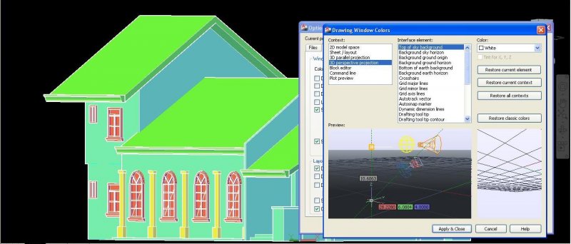

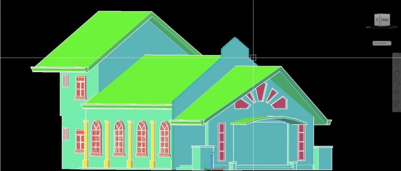

Rewind23 Posted May 22, 2011 Posted May 22, 2011 Hi there, i am currently working with this drawing but im having some trouble with some settings..i can render the materials, but i can not set the background of my drawing..meaning, the 3D Perspective Projection background...i attached a photo so you can identify the problem...and what i am seeing in my monitor.As you can see, on the first image, when i select the 3d perspective projection(under drawing windows) after selecting it, it didnt take in effect Also may i ask how to set the "sky effect" background? because i wanted to render this drawing to the best projection it can be...your help is highly appreciated...Thanks in Advance! Regards.... Quote
Rewind23 Posted May 24, 2011 Author Posted May 24, 2011 command background @dedmin, ok il try it..thanks. to all: if you have other recommendations please help..thanks Quote

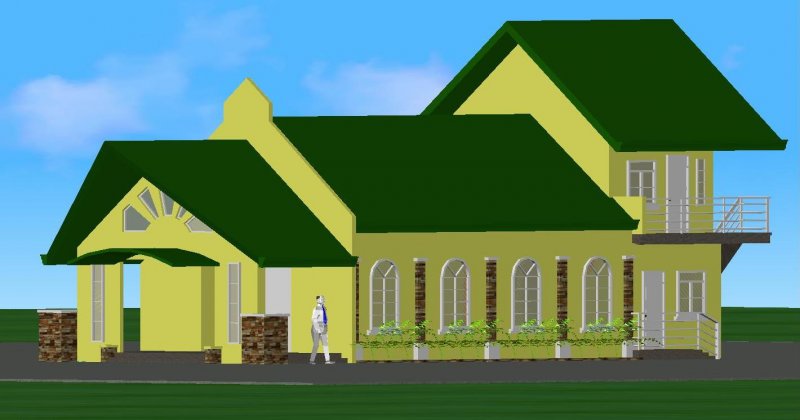

Rewind23 Posted June 4, 2011 Author Posted June 4, 2011 Hi there, I have now the rendered 3D model of the one i posted please check this out..your comments and suggestion is higly appreciated..the rendering is not quite good..and im hoping to improve it..Thanks to Mr. CAD64 for bringing up some helpful tips(links)....your the man! Quote

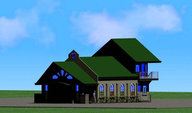

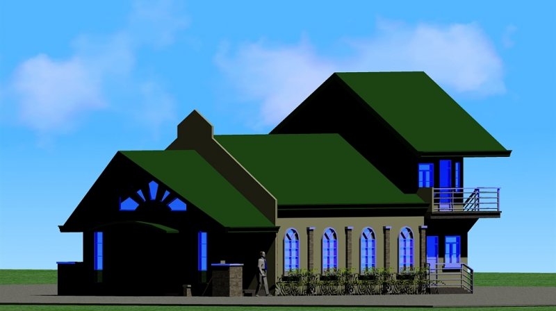

Rewind23 Posted June 4, 2011 Author Posted June 4, 2011 Hi, attached is the rendered with shadow of sun...can you help me how to set the right angle of the Sun?Because if you notice, the front elevation of the model is covered with shadows and with that i wanna improve it to make it a more realistic model(atleast to me as a newbie .....here is my rendering details: Geographic Location: Sun: On Inensity factor: .2000 Shadows: On Sky Status: Off Intensity factor:1.0000 City: Manila, Philippines Time ZOne: (GMT+8:00) Kuala Lumpur, SIngapore Latitude Direction: North Logitude Direction:East hope to hear any suggestions and comments..for the learning improvement...More power to All! Thanks in Advance! Quote
Cad64 Posted June 4, 2011 Posted June 4, 2011 can you help me how to set the right angle of the Sun?Because if you notice, the front elevation of the model is covered with shadows Have you tried changing the time of day? Quote
Rewind23 Posted June 4, 2011 Author Posted June 4, 2011 Rewind23 Hi, attached is the rendered with shadow of sun...can you help me how to set the right angle of the Sun?Because if you notice, the front elevation of the model is covered with shadows and with that i wanna improve it to make it a more realistic model(atleast to me as a newbie .....here is my rendering details: Geographic Location: Sun: On Inensity factor: .2000 Shadows: On Sky Status: Off Intensity factor:1.0000 City: Manila, Philippines Time ZOne: (GMT+8:00) Kuala Lumpur, SIngapore Latitude Direction: North Logitude Direction:East Quote
Rewind23 Posted June 4, 2011 Author Posted June 4, 2011 Hey Mr.Cad64, yup i did..i tried setting the time at 930am but after changing it and do the rendering the shadow is still all over the front elevation of the model... Thanks again! Quote
iskalipsi Posted June 4, 2011 Posted June 4, 2011 Hello there Rewind23.Turning your global illumination and final gather might help you with your shadow problems. And try changing the time until you'll get the results you wanted. Quote
Rewind23 Posted June 4, 2011 Author Posted June 4, 2011 Hello there Rewind23.Turning your global illumination and final gather might help you with your shadow problems. And try changing the time until you'll get the results you wanted. @iskalipsi: ok il try it..Thanks Quote
Patrick Hughes Posted June 4, 2011 Posted June 4, 2011 Regarding the shadow/time of day: Perhaps changing the orientation of the building and camera position. Or add a fill light? Just a couple of thoughts, I don't have experience with this type of lighting. Quote
Rewind23 Posted June 5, 2011 Author Posted June 5, 2011 Regarding the shadow/time of day: Perhaps changing the orientation of the building and camera position. Or add a fill light? Just a couple of thoughts, I don't have experience with this type of lighting. @ Patrick: Hey its a good suggestion...i havent thought of that because im stuck with this perspective view..il try it though..Thanks! Quote

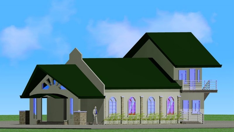

Rewind23 Posted June 7, 2011 Author Posted June 7, 2011 Hi Guys, here is the development of my rendering....so far so good..(atleast to me)...thanks to iskalipsi and cad64 for bringing useful tips (Thumbs up!) and to other members who spend time to share their knowledge...you know who you are... any comments and criticism is encourage for further improvement of my 3d model..thanks! more power to all of us! Quote
Cad64 Posted June 7, 2011 Posted June 7, 2011 any comments and criticism is encourage for further improvement of my 3d model.. Well, you have a smooth, flat, green roof. Try adding a texture to it, like a wood shingle or tile. Also, it looks like there is no backside to the building? Maybe it's just the reflectivity of the glass, but it looks like you can see through to the other side. Other things to think about: Cars in the parking lot Trees and shrubs scattered around Some sort of background image It's getting better. Keep working on it. Quote
Rewind23 Posted June 7, 2011 Author Posted June 7, 2011 Hi cad64, your right...thats what exactly im thinking about..to put some landscaping material....il try to add some...thanks for that bright idea...im just wondering about the roof...is that texture your talking about is through "HATCH"?or a 3d tile?thanks Quote
