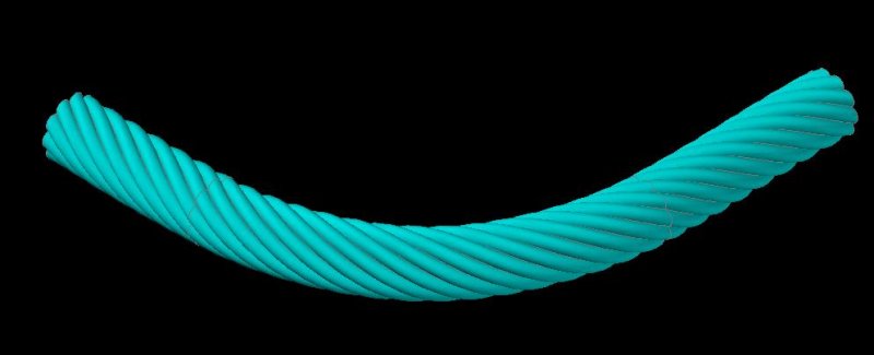

Jack_O'neill Posted May 21, 2011 Share Posted May 21, 2011 Something like this perhaps? Draw the shape of the end of the cable first. I did it by polar arraying circles so that they overlapped, then trimmed out all but the outer bits to get that "scalloped" shape. Pedit it into a polyline, then sweep it along the a path where you want the cable to be, using a "twist angle". The longer the cable, the more twist you'll need to create the illusion. What you see here was 270° on a random length line approximately 7 inches long. Quote Link to comment Share on other sites More sharing options...

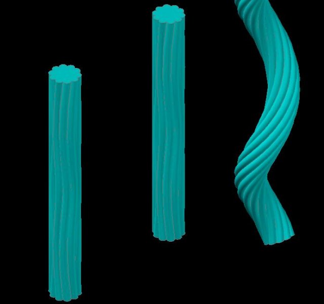

Jack_O'neill Posted May 22, 2011 Share Posted May 22, 2011 How about using a helix? The connector at each end shouldn't be all that difficult. Connector is nothing. Easy bit that. I tried using helix 2 different ways (see below). The one on the right was created using the shape I described above swept along a helix. The one in the middle was created by sweeping one of the single small circles along a helix, then arraying it around it's self followed by a union. Didn't come out quite right. The one on the far left was created by taking the scalloped shape, copying it every inch and rotating it 18° each time. The 18° is the angle between the center of the "hump" and the bottom of the "valley", and lofting. Still didn't look quite right. It might work, but somebody smarter than me will have to figure it out. Sweep with a twist was the easiest way I could find. Quote Link to comment Share on other sites More sharing options...
Jack_O'neill Posted May 22, 2011 Share Posted May 22, 2011 Here's one bent round a corner. This uses a twist angle of 1080, or three full turns. The bigger twist angle you use, the more like a helix it looks. Quote Link to comment Share on other sites More sharing options...

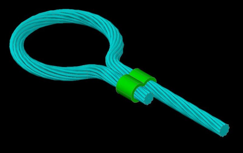

Jack_O'neill Posted May 22, 2011 Share Posted May 22, 2011 Here's a loop with a crimp fitting. "I'm through playin' now" as Minnie Pearl used to say. --oops...forgot the grommet. oh well-- Quote Link to comment Share on other sites More sharing options...
danellis Posted May 22, 2011 Share Posted May 22, 2011 --oops...forgot the grommet. oh well-- Here'ya go' date=' Jack. dJE Quote Link to comment Share on other sites More sharing options...
Jack_O'neill Posted May 22, 2011 Share Posted May 22, 2011 :lol::lol: That's great! Thanks!! Quote Link to comment Share on other sites More sharing options...

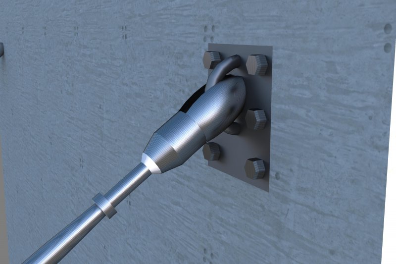

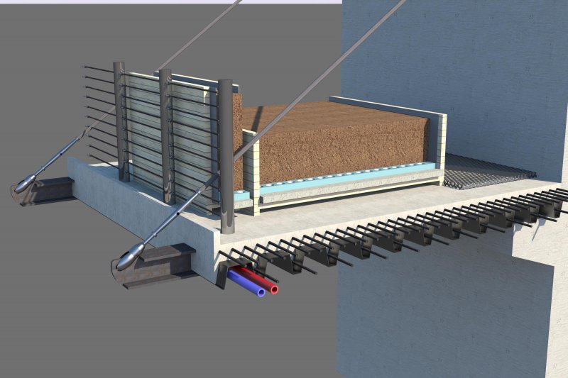

Posho91 Posted May 26, 2011 Author Share Posted May 26, 2011 Worked out in the end using the sweep and twist, just had to isolate and use 2d wireframe whenever I moved anything so the pc didnt crash. Thanks chaps. Quote Link to comment Share on other sites More sharing options...
Jack_O'neill Posted May 26, 2011 Share Posted May 26, 2011 That's great. Glad you got it to work out. Nice renders! Quote Link to comment Share on other sites More sharing options...
Organic Posted May 26, 2011 Share Posted May 26, 2011 That looks very nice. Quote Link to comment Share on other sites More sharing options...
Patrick Hughes Posted May 26, 2011 Share Posted May 26, 2011 Nice work. It looks like you have a clearance issue if the clevis ever needs to pivot up. Quote Link to comment Share on other sites More sharing options...
Posho91 Posted May 27, 2011 Author Share Posted May 27, 2011 Thanks. Ah yes I see what you mean...well luckily this is a student project and tutors don't tend to pay attention to such things Quote Link to comment Share on other sites More sharing options...
Patrick Hughes Posted May 27, 2011 Share Posted May 27, 2011 Thanks. Ah yes I see what you mean...well luckily this is a student project and tutors don't tend to pay attention to such things Well, they need to. I dislike the term but it presents a "teachable moment' into the real world, after all isn't that one of the benefits of modeling in 3d? I would perhaps leave it as such and point it out as a "fault". Quote Link to comment Share on other sites More sharing options...
