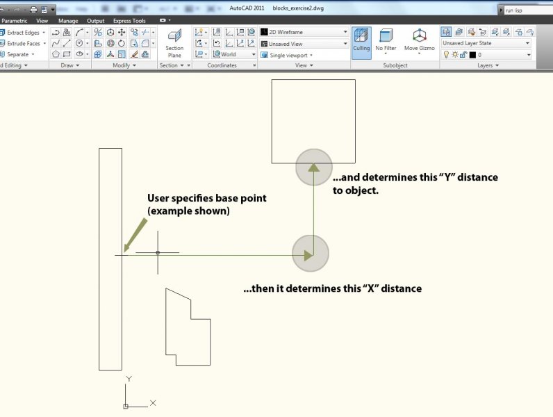

And oh yea, next thing: What I need to do ideally, which I just realized, is this: The measurement I need to create is an X,Y coordinate. So I'd need to measure from a basepoint (say, a midpoint on a back wall), then a distance along X to a point where I then up Y to the object, creating two separate distances. Does this make sense?
No, not at all... Perhaps a screen shot would help?

Is there a block located at the final destination (you only show the midpoint of what I beleive to be a wall)?
Otherwise, the distance and coordinate extraction is not a problem.
The block on the left (long thin rectangle) is my 2-second scribble representation of a wall. So the measuring is going from the wall point on the left up to the square.
I'm combing through AutoCAD's documentation on this too. So far I'm finding mostly general, broad-strokes sort of information, but that's probably because I don't know what to look for as well yet.
This is the part I need for you to be more specific.
At the destination point you show, will there be (is there) a block representing the device (i.e., monitor, speaker, etc.), or is the square-like shape the block itself, and the destination point shown is that blocks insertion point?
Also, what is your block naming conventions (i.e., "Monitor_001", "001-speaker", etc.)? Try to be as specific as possible, for each of the blocks you 'd like to use this routine on.
Gotcha. Sorry, the LISP language is literally new to me as of Wednesday. I plan on spending the rest of the next few weeks in my spare time trying to get my head around programming for LISP.
The naming will be keyword first, so, Box_001 or GoBo_001, etc. So in this drawing I'll call the square "Box_001". The basepoint is against the middle of that rectangle on the left, which represents a wall. So when the script runs and asks me to Specify Base point, that's where I'm starting in this example. The point on the blocks can be anywhere, but I think I'll make it the midpoint on the bottom edge.
The weird-looking shape in the bottom of the drawing can be ignored.
