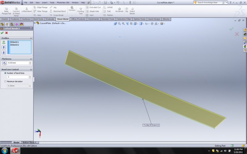

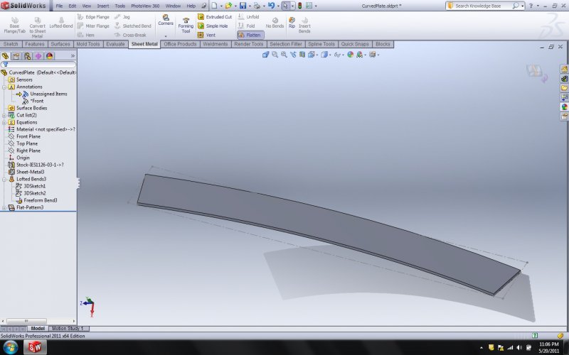

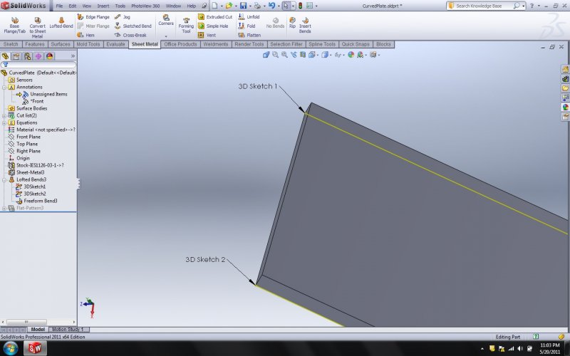

This may not be the best or only way but you can accomplish this with the loft feature. You will need to create a couple of 3d sketches from the original imported solid. See attached photos, hope it makes sense.
