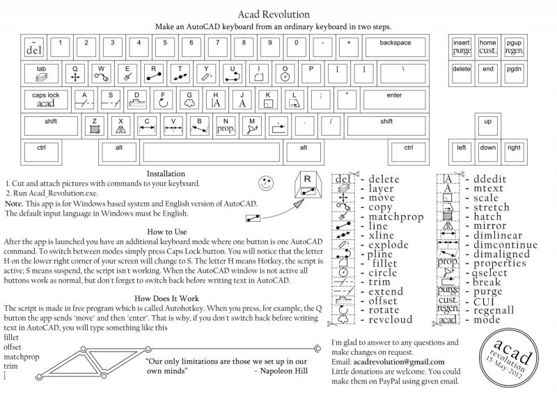

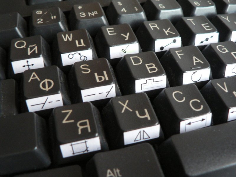

Pretty cool there. I had a Nostromo Speedpad n52 for a while but I just could not get the hang of it with CAD. I even tried it with my FPS pc games but I just fell back to using my keyboard :(
I am using a black Mac clone keyboard right now and I love it.
http://www.i-rocksusa.com/products/KR-6402-BK.html
I use a Logitech MK550 Wireless Wave Keyboard and Mouse at home.
Very comfy to use.
For work, I use the stock Dell keyboard that came with the computer. I might see about upgrading, though, especially after seeing the tutorial above.
