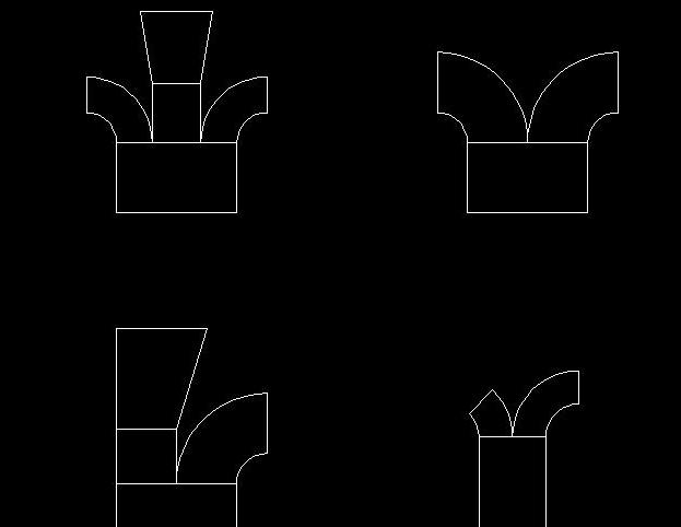

I would be thankful if someone would like to share their lisp for creating duct elbows (both round & rectangular).
For those that are not in the HVAC field...I would like to request a lisp that would draw:
Sorry for the super large picture. I didnt have a chance to resize it.
So the lisp would prompt for a start point. (preferably a mid snap)
Prompt for diameter.
Prompt for the radius. (If radius is 1 then the inner radius equals the diameter, the outter radius is equal to inner radius + diamter. If radius is 1.5 then the inner radius is 1.5 times the diameter and so on.)
Thanks in advance.

What software do you use? Probable it can be donne with a dynamic block.
I use ACAD 2006. Can you eleborate on how this can be done with dynamic blocks?
I was under the impression that dynamics blocks are just blocks that one can edit without exploding them. Are you referring to using the tools pallette?

Hi LSA,
here my code,I just create special for you,and test it
(defun c:test (/ loc rad p1 p2 el1 dia p3 el2 p4 el3 el4)
 (setq loc (getpoint "\nClick any location for object<0,0,0>: "))
 (if (= loc nil)(setq loc '(0 0 0)))
 (setq rad (getdist "\nEnter radius for duct<1>: "))
 (if (= rad nil)(setq rad 1))
 (setq p1 (polar loc 0 rad))
 (setq p2 (polar loc (* pi 0.5) rad))
 (command "_arc" "c" loc p1 p2 "")
 (setq el1 (entlast))
 (setq dia (getdist "\nEnter diameter for duct<2>: "))
 (if (= dia nil)(setq dia 2))
 (setq p3 (polar p1 0 dia))
 (command "_offset" dia el1 p3 "")
 (setq el2 (entlast))
 (setq p4 (polar p2 (* pi 0.5) dia))
 (command "_line" p1 p3 "")
 (setq el3 (entlast))
 (command "_line" p2 p4 "")
 (setq el4 (entlast))
 (command "_region" el1 el2 el3 el4 "")
This work for me in A2005:
(defun C:duct (/ bpt cpt dia pt rad tpt ulp urp x y)
 (setvar "cmdecho" 0)
 (setvar "osmode" 0)
 (setq    dia (getreal "\nEnter diameter :\n")
   rad (getreal "\nEnter duct radius as diameter fraction : \n")
 (setq pt (getpoint "\nEnter insertion point of duct \n"))
 (setq    x   (car pt)
   y   (cadr pt)
   bpt (list x (- y (/ dia 2)))
   tpt (list x (+ y (/ dia 2)))
   cpt (list x (+ y (+ (* dia 0.5) (* dia rad))))
   ulp (list (+ x (* dia rad)) (+ y (* dia 0.5) (* dia rad)))
   urp (list (+ x dia (* dia rad)) (+ y (* dia 0.5) (* dia rad)))
 (command "arc"  "C"     cpt    tpt    ulp    "arc"  "C"    cpt
      bpt      urp     "line"    tpt    bpt    ""     "line" urp
      ulp      ""
 (setvar "osmode" 703)
 (setvar "cmdecho" 1)
;Test : (C:duct)
~'J'~
Thanks guys. Both worked fine. I will tweak it alittle to suit my needs. :)

LSA any chance you could shrink that image down a bit its humungous, makes it hard to read the post. :)
Thanks Hsmurf. Although I am only able to draw straight ductwork and transitions with your lisp.
Am I missing something?
BTW, i resized the pic but its not very readable anymore. :)
I would crop the image. The margins are so width and holding no info.

Just seen you other threads on drawing double line. :) Nice to meet someone else in the same HVAC industry using CAD.
If youve got any HVAC lisps yourself that youd like to share thatd be cool 8) .I tried to start a thread on here for HVAC lisps but didnt get much of a response.
  • 4 years later...
The lisp code posted has the formatting of this changed? Could you possibly send me the lisp file?
Thanks for your quick reply! Finally a lisp that includes small ends! im guessing you dont have a version that includes centre lines? ;)
Im a novice lisp writer, which sucks! I really want to start writing things that suit my needs.
In regard to my last post, i found you erase the centre line at the end of the lisp. I have just removed that line. Works great small ends and centre line!
*Wishes it did more than 2 lines*
