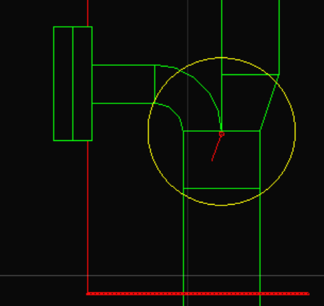

ReMark Posted September 21, 2020 Posted September 21, 2020 Toe clearance refers to the space below the base cabinets in a kitchen. The damper is pictured below, in red, within the yellow cirlce. 1 Quote
Rave Posted September 27, 2020 Posted September 27, 2020 (edited) Thanks @ReMark I managed to finish plate1. I am now trying to understand which part of the hvac i am supposed to draft in plate 2, i dont see a duct/transition piece that is 10x14x6. . Is this the one near the nook? I am trying to understand using the images here on cad tutor about plate 2 but not able to make it out still. Is it the trasition piece that is the east split (going to bathroom 2) from the inside unit? Edited September 27, 2020 by Rave Quote

ReMark Posted September 27, 2020 Posted September 27, 2020 Refer to the images in the link posted by dgolchuk above. The student is being asked to create a "pattern" of the transition piece. 1 Quote
Rave Posted September 28, 2020 Posted September 28, 2020 Thank you ! If you dont mind, could you explain where this transition is actually located on plate 1 (just to get a rough idea ,i am trying to understand which transition piece the instruction refers to, is it the one that starts from the inside unit and goes to bathroom 2?) Quote
ReMark Posted September 28, 2020 Posted September 28, 2020 There are two 10x14 transition pieces on the ductwork running from the furnace towards bathroom #2. Quote
