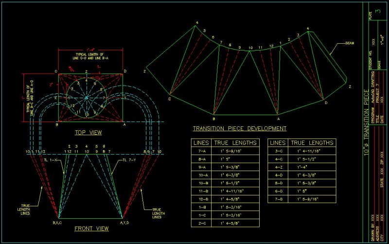

coreyjaywilliams Posted August 1, 2013 Posted August 1, 2013 yes, i figured out, you take the length from top view (example 4-a) take the length, then make an arc with the radius of said length, then extend it down to form true lengths with the front view Quote
celestinaeyang Posted February 24, 2014 Posted February 24, 2014 Hello! I need help for HVAC PROJECT, I am right now doing the plate 3. I am confused with how to get the true lenghts. Can someone help me? Quote
ReMark Posted February 24, 2014 Posted February 24, 2014 Isn't the process of obtaining the true lengths demonstrated in some of the images included in this thread? You might want to also take a look at this thread. http://www.cadtutor.net/forum/showthread.php?68156-Penn-Foster-HVAC-transition-piece Quote
celestinaeyang Posted February 24, 2014 Posted February 24, 2014 I read the explanation that they give about plate 3, but I am still confused. At the attechment I send you What did I do so far. My problem now is how to establish the true lenghts. HVAC PLATE 3.dwg Quote
ReMark Posted February 24, 2014 Posted February 24, 2014 Did you look at the link I provided? I think forum member JD Mather explained the process. Quote
