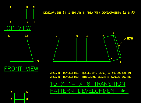

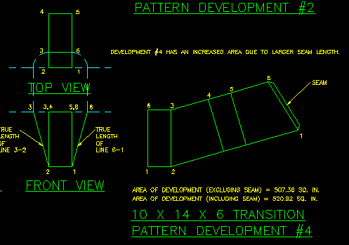

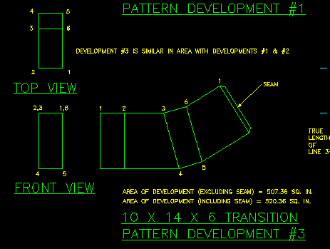

solo8591 Posted April 7, 2013 Posted April 7, 2013 hello all ,Remark. please is any one has the HVAC plate#2 labeling on the numbers , i did the drawing but got confusing how to label them . i see some pdf picture put it is very hard to see how the numbers labeled please help in this one Quote
ReMark Posted April 7, 2013 Posted April 7, 2013 I probably have it on my work computer. Will look first thing Monday morning. Quote
solo8591 Posted April 8, 2013 Posted April 8, 2013 Thanks Remark that is great !!,it help to see how the # go ,thanks again. Quote
ReMark Posted April 8, 2013 Posted April 8, 2013 I can post the remaining three developments Tuesday morning if need be. Quote
coreyjaywilliams Posted August 1, 2013 Posted August 1, 2013 I am on plate three, does anyone have a list that clearly defines the true length measurments, im stuck!! (a-10, b-10 etc...) Quote
ReMark Posted August 1, 2013 Posted August 1, 2013 Unless the dimensions are included in the instructions PDF there is no list of true dimensions that I am aware of. Unfortunately I do not have access to a PDF for this segment of the P-F AutoCAD course. Did you look at post #6? Quote
