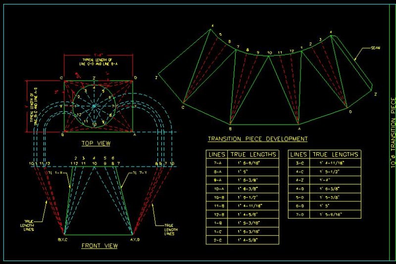

Autocadstudent Posted May 14, 2011 Posted May 14, 2011 I am trying to draft the 10x1406 hvac pattern and 10" diameter transition piece. Can you please post an image of them. Thank you. Quote
ReMark Posted May 14, 2011 Posted May 14, 2011 Post of image of what you have so far. Is this a Penn-Foster project? Quote

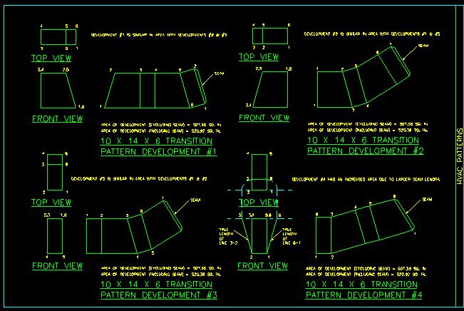

Car5858 Posted May 15, 2011 Posted May 15, 2011 Are these the ones that you are trying to do? Remember that your project may be different. Quote

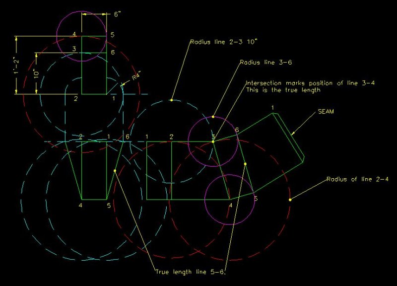

Megaforce1 Posted July 9, 2011 Posted July 9, 2011 Hello: I am a little confused with the HVAC 10x14x6 pattern developments: We are to do 2 pattern developments in which the front views show the transition's larger side (14" wide) and 2 pattern developments in which the front views show the transition's narrow side (10" wide). My first 2 pattern developments look similar to CAR5858's post #3 top two. But, I am stuck about how to start the other two. What do the 2 bottom pattern developments of Car5858 show. Can someone post an image of how the narrow side (10" wide) should look, or am I missing something? Thanks!!! Quote
Car5858 Posted July 9, 2011 Posted July 9, 2011 Megaforce1 This is a little complacated, but you can see the development process. First find the true length of line 3-4 (red dashed circle), next find the position line 2-3 (cyan circle). Since lines 2-3, 3-6, 6-1, and 1-2 represent the narrow side, these are at the top of the flat pattern (see screen shot). Use the circles to lay out the flat pattern. By positioning the circle radius at their respective point, the intersections of the circles create the end points of the stated lines. Quote

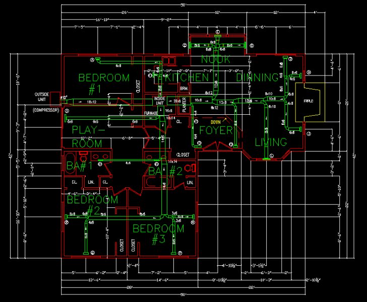

Car5858 Posted August 27, 2011 Posted August 27, 2011 Wendymoose, you should be starting a new thread with your question. Use Penn Foster HVAC plate one as the title. Plate one is the floor plan with the ductwork. Do you have the floor plan completed? Are you stuck on the duct layout? The instructions were pretty clear in this section. I did not have a problem with it. You will also have to add a table to the right of the drawing. This is explained in the instructions. Quote
wendymoose Posted August 27, 2011 Posted August 27, 2011 hi again Car5858, I was trying to lay out the rooms from page 10 of the project book. omg, I am terribly sorry. I received a sample plate drawing with my project book and just did not realize that this is what they are wanting me to copy exactly. I was getting confused because I could not find the play-room dimensions along with bathroom #2. Thank you for clearing that up for me. I was trying to go with the instructions straight out of the book instead of just copying what they sent me. Never thought it would be that easy and I appreciate you helping me clear that up. Thank you Quote

randy3081 Posted December 6, 2011 Posted December 6, 2011 car could you please post a shot of plate A of hvac drawing. Yours is blurry when i zoom in on it to see how you do the bends and transitions of the duct. thanks sir Quote
ReMark Posted December 6, 2011 Posted December 6, 2011 Plate A? I thought the HVAC project had plates 1 through 3. Which post is the image in that you are referring to? Quote
randy3081 Posted December 7, 2011 Posted December 7, 2011 it is the post on page 1 where car provides screen shot of plate 1(sorry). I just can't see the details on his drawing for the correct placement. the screen shot is blurry when zoomed in. Quote
ReMark Posted December 7, 2011 Posted December 7, 2011 (edited) Plate 1? I'll see what I can do. Any better? Edited December 7, 2011 by ReMark Quote
randy3081 Posted December 8, 2011 Posted December 8, 2011 yes it is a tad bit better. I was wondering where did the kitchen sink come from? There was nothing i read about the sink or it's dimensions. Carr and yourself both had it on the plate as well. Quote
ReMark Posted December 8, 2011 Posted December 8, 2011 Disclaimer: I did not take the Penn-Foster AutoCAD course. Drawings or portions of drawings that I post were created by other students. A tad better? What are you reading these on a cell phone screen? I suspect that any "extras" not specifically called for in the instructions were added by the student looking to give the drawing a more finished look. Quote
randy3081 Posted December 9, 2011 Posted December 9, 2011 yes slightly better and no im not reading on a cell phone. it is on my computer when i open the link it gives me a screen shot of approximately 6x6. when i zoom in it becomes distorted. The sink situation i understand. Thanks for your attempt Quote
