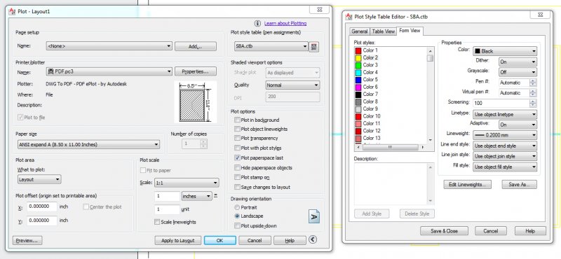

tennis4you Posted May 12, 2011 Posted May 12, 2011 A friend of mine sent me his color dependent .ctb file and I have modified it and I am ready to give it a test run. When I go into layout mode and tell it to print a PDF I see int he preview that all the lines are colored. Are they not supposed to be black and white? I am new to all of this so I apologize if this is an easy one. Been using another CAD program for 12 years, I am liking AutoCAD but learning all this standard stuff is brutal. Quote

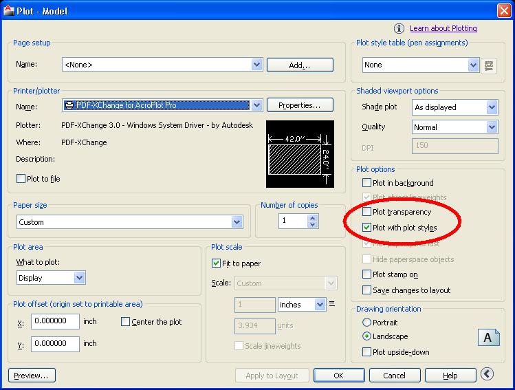

Dana W Posted May 13, 2011 Posted May 13, 2011 Thanks for the quick reply. This is odd though, this is the same table his firm uses and they are all black and white. The table specifies that the main 8 colors are to print black too. So I am still curious why they want to print color. Hmmmmm. Is the 'Plot with Plotstyles' box checked off? Sorry, somebody has to ask if you've checked the gas guage. I am still wondering why you don't use a plotstyle that you know will plot all black instead of that custom one. Quote

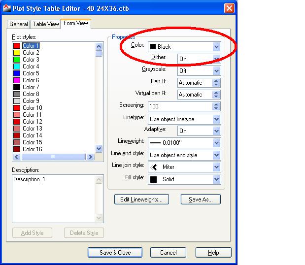

qball Posted May 13, 2011 Posted May 13, 2011 on my ctb files in Plot Style Table Editor all the Properties are set to Color: Black. It's the Lineweights and Screening that vary between colors. Using the standard monochrome.ctb may not give you the lineweights you desire based on the colors in your drawing. Quote

tennis4you Posted May 13, 2011 Author Posted May 13, 2011 Hmmmmm. Is the 'Plot with Plotstyles' box checked off? Sorry, somebody has to ask if you've checked the gas guage. I am still wondering why you don't use a plotstyle that you know will plot all black instead of that custom one. I wish I knew where the gas gauge was. I do not see that option in the .ctb file or under "Options - "Plot and publish". The main reason I am using this color table is because a friend of mine uses it and I assumed it would be a good start. I am so lost in all of this it is crazy. Quote
qball Posted May 13, 2011 Posted May 13, 2011 See if either of these help. If not, then post a similar screen shot of your setup and maybe we can figure it out. Quote
tennis4you Posted May 13, 2011 Author Posted May 13, 2011 OK, I am set to black as shown on the first image. I do have "Plot with Plot Styles" checked though. Does that need unchecked? Doesn't seem to make much different except the orange lines preview as orange, for some reason when it is checked they print black. And by the way, I really appreciate everyone's help! I have used MicroStation for 12 years and knows the ins and outs of it well. I am starting my own firm in 3 weeks and I have decided to finally start using AutoCAD. The help here is a million times better (and nicer) than the one place you can go to get MicroStation help... You guys rule! Quote

Dana W Posted May 14, 2011 Posted May 14, 2011 OK, I am set to black as shown on the first image. I do have "Plot with Plot Styles" checked though. Does that need unchecked? If you don't check that box, it will not use the plot style table at all, and plot everything straight from the object colors. Quote
