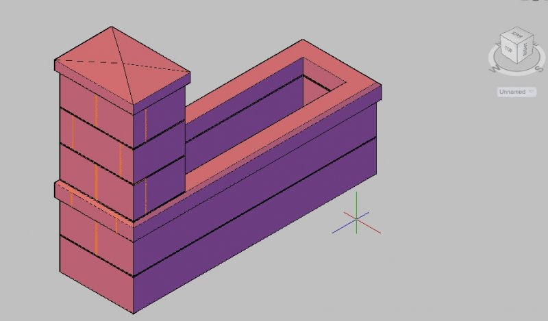

Mason Dixon Posted May 12, 2011 Posted May 12, 2011 I am trying to draw lines(orange colored) on this 3d object(crimson colored). Every time I go to select the lines to alter them I end up only being able to select the 3d object they are on. How do I turn off the selection of the 3d objects or anything on that layer? Quote
qball Posted May 12, 2011 Posted May 12, 2011 (I'm not sure if this all applies to Acad 2010) You can Hide the box, or Isolate the orange lines, or Isolate the Layer that the orange lines are on. Or does 2010 have Selection Cycling on the bottom left taskbar? or this: http://docs.autodesk.com/ACD/2010/ENU/AutoCAD%202010%20User%20Documentation/index.html?url=WS1a9193826455f5ffa23ce210c4a30acaf-6783.htm,topicNumber=d0e101570 Quote

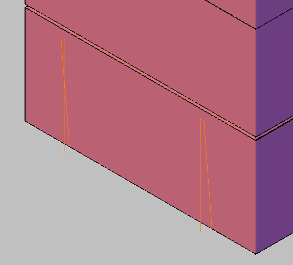

Mason Dixon Posted May 12, 2011 Author Posted May 12, 2011 My problem is that I'll start drawing on what I think is the 3d face and come to find out i'm drawing in some other dimension. when i go to select the lines to correct them I can't because i can only select the 3d object i'm trying to draw the lines on....very frustrating. Not sure how to tell if dynamic ucs is on. Thanks for your help, i'll try over in the 3d forum. Quote
qball Posted May 12, 2011 Posted May 12, 2011 The Icon for Dynamic UCS is on the bottom left of the screen, with Snap, Ortho, etc. http://docs.autodesk.com/ACD/2010/ENU/AutoCAD%202010%20User%20Documentation/files/WS1a9193826455f5ffa23ce210c4a30acaf-7192.htm If you rotate your view I assume the orange lines are off in space somewhere? Away from the solid? If so, then UCS Face or Dynamic UCS is for you! (some people on here hate double posting) Quote
Mason Dixon Posted May 12, 2011 Author Posted May 12, 2011 I'm trying to draw lines on a 3d object's face. 9 times out of 10 I'll be drawing and try to check my work by putting it in isometric view and find out I've been snapping my lines to points in other dimensions. How do I select a 2d face, keep it selected, and be able to draw only on that 2d face and not behind it on some other snapmode? thanks Quote

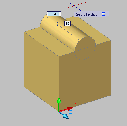

Mason Dixon Posted May 12, 2011 Author Posted May 12, 2011 Side question...how do I make my 3d objects look shaded like this? nm....figured it out, visual styles Quote
SEANT Posted May 12, 2011 Posted May 12, 2011 Perhaps set Dynamic UCS to on with OSNAPZ = 0. It costs AutoCAD some snapablity, however. Quote
qball Posted May 12, 2011 Posted May 12, 2011 View tab > Visual Styles. There's a pull down menu that probably says 3d hidden on yours right now. Check out Cad Tutor main page and Youtube for some UCS tutorials. I can't seem to explain it any better. Quote
Mason Dixon Posted May 12, 2011 Author Posted May 12, 2011 (edited) thanks but it was already set to 0 My whole goal is to draw mortar joints for this architectural piece....its taken me hours to put those few simple little orange mortar lines in This is what I typically run into with my lines snapping to points that are not on the face I want to draw on Edited May 12, 2011 by Mason Dixon Quote

SEANT Posted May 12, 2011 Posted May 12, 2011 Oops, I should have said OSNAPZ = 1. Also, set NEA/MID, and PER running osnaps. Does anyone else find it entertaining that Mason Dixon wants to draw a line or am I the only nerd? Quite clever. Quote

CADguy209 Posted May 12, 2011 Posted May 12, 2011 You might want to use UCSICON command and set it to ON. Also the under the UCS command you can use the 3 point option to define the origin and x/y axis. This will allow you to align the ucs to faces on your model so that you can draw your lines or other features on it. Under the View pull down or tab there should be the shade command wich will give you different options for displaying the sahding of your model. Or you can jsut type SHADEMODE at the command line. Quote
