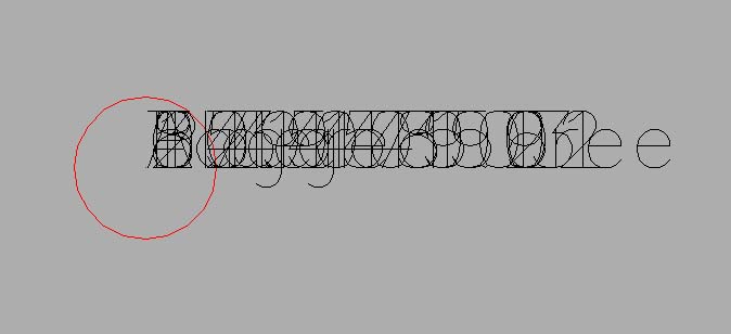

Hello,
I've tried the ddptype and that enables me to see the points on the screen. In answer to irneb's question I think these are probably point entities...but I'm not entirely sure. Each of the 378 blocks represent trees, so they have different locations, id numbers and species, etc. I need to display the trees on a plan and indicate only their id numbers.

PointDataTest.dwgHello,
Thanks to everyone for your help so far. I've attached a slimmed-down drawing, as the original was too large. All I need to do is show a circle symbol on the drawing and the id number next to it.
As you can see, each point and the attributes is collected as a different block making it dfficult to edit all the blocks in one go.
As always, all help is greatly appreciated.
Alistair :)
DWG Updated to AutoCAD 2004
CyberAngel is correct! Your drawing contains blocks with points inside them and hidden attributes.
The only way to get them to show the attributes is to redefine the block's definition. Unfortunately though each instance in your drawing has a separate definition (i.e. block name), ranging from BLK0-BLK379. To make life easier, try using the Express Tool - BlockReplace to merge them all to one common definition. Then edit that def as CyberAngel's explained.
To unhide the attributes, select them while inside the block definition and change their "Invisible" property to No in the properties palette. BTW, your blocks seem to have some strange settings for the attributes. Might want to modify that as well as work with some layering so you can more easily turn on/off the data fields.

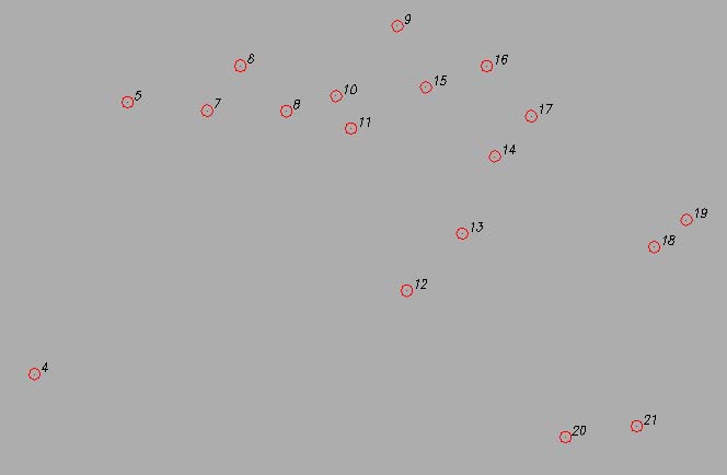

Using tools available to me, I have got this in a little time. If it is only a one off, then I can do something like this for you. If it is an on-going problem, then you will have to get a lasting solution.
Basically, I extracted the attributes using only the Easting, Northing and the ID. Then I replotted them.

All the blocks were inserted at 0,0 with the Easting and Northing as attributes. That is why all the blocks are different. The GPS program is making the blocks to a pattern, but as I said previously, the method is not very user friendly for doing other things.
But I extracted the Easting and Northing attribute together with the ID attribute, and then using a survey plotting programme, re-plotted all the IDs as text, and made the point as a circle. So I have not edited any blocks, but the original blocks are there. This is purely a visual solution for your needs.
