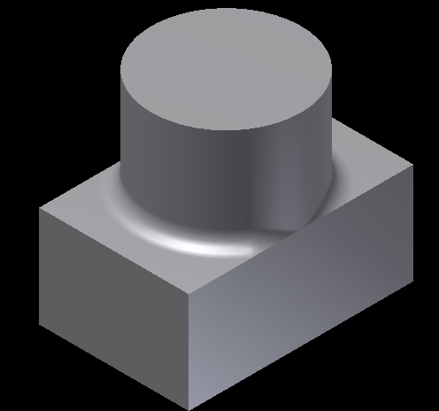

Have placed a cylinder on top of a rectangle. E&W/0°,270° are tangent to rectangle's edge(s) .............rectangle extends beyond 6&12.
Have radiused the corners of the rectangle but am not making the fillet work at the juncture of the cyl and rectangle.
Tried multiple times, doing best to follow commands/requests but no joy. I did on several occasions end up with what I can best describe as the radius running inward toward the cyl's C/L........therefore my "convex" description. The opposite of the desired weld type fillet.

When I said rectangle, it is an extrusion. I changed my UCS every which way from Sunday in case I was getting hung up there, nada.
To add your file...Go Advanced>Manage Attachments>Choose File>Upload>Close window.
If you can't get a fillet to work in a particular location, you may get Circle TTR to work. Start the Circle command, type T, pick two objects, and input your radius. The resulting circle will be tangent to both objects.
Assuming that doesn't work, can you at least post a screen shot? In these situations, a picture really is worth a thousand words.
Cylinder and box. Did you Union them before attempting fillet?
"Monission.........??? I must be fried - had the final this week.
I failed (in a semi epic manner) to union.
