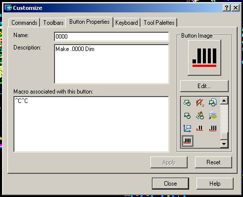

I'm beginning to learn how to make my own toolbar buttons for ACAD 2004 yet am having trouble figuring out what I would write as the macro command for the operation in the button creation dialog box for a specific operation.
There will be 3 buttons. One for .XX, one .XXX, one .XXXX precision edit of an existing dimension. IOW, if I have a 2 place precision dimension and wish it to be 4 place, I'll click the '.XXXX button' then click the dimension and it will change to 4 place. In addition, I'd like for it to update immediately for multiple dimension picks if possible just like 'match properties'.

Though I understand what you mean about "not" surpressing trailing zeros (as in .25 converted to .2500 would still show as .25), for myself that should not be an issue only ever surpressing leading. However and I'm sure it due to my ignorance, I tried utilizing the script you took time to generate and only received an error message for "too many arguments". Most likely placed in the wrong area as it would not apply to the customize screen, yet only in the current menu area.....In any case in the customize window is where I have made others with some success.
It is within the "Macro associated with this button" pane where I would normally place the text....Is that the correct place for your script above?

There is a few ways you could do this:
1. You could use the following macro on your toolbar button.
^C^Cdimdec;4;^C^C-dimstyle;A;\;;
You can use this same macro for all the buttons, you will just have to change the value "4" to match the number of places/percision you want the dimensions to be. The problem with this is that you will be creating style overrides for whatever the current dimension style is. To get rid of the style overrides you could add another line to the macro to restore the current dimstyle. But this means that you would have to write in the dimension style name into the macro code. So if you use different dim styles this may not work since the macro will only have the one style name in it that gets restored. Of course if you dont care about the style overrides then it wont matter.
