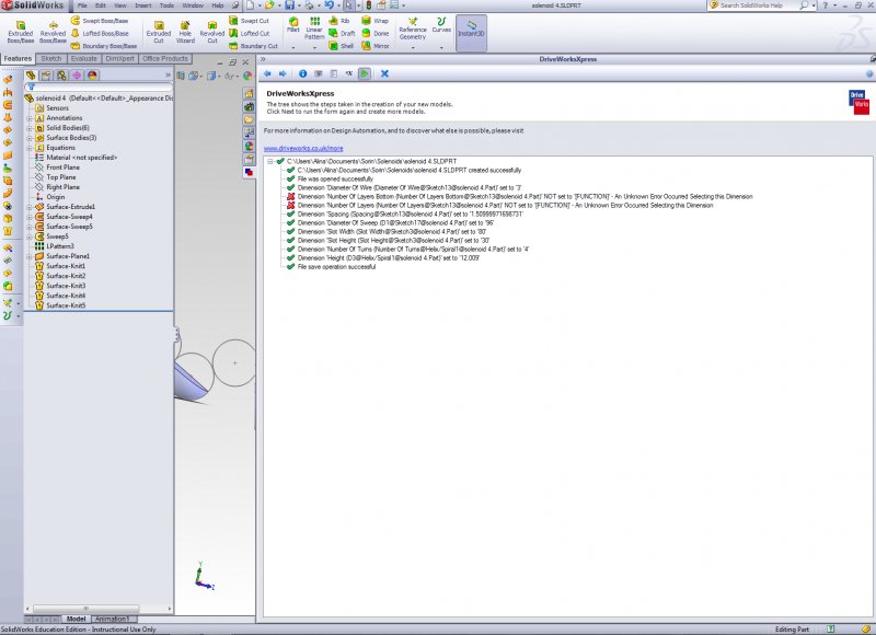

I am having trouble getting the rules to work in driveworks.
Specifically I cant seem to use ROUNDUP or ROUNDDOWN. There also doesnt appear to be a % function to get a remainder so I cant figure out a way of rounding a number up or down. I need to be able to do this to get my sketch pattern work and give me the alternating wires.
Right now my equation for the top number of layers is
=ROUNDUP(NumberofLayers/2)
and the bottowm number of layers is
=ROUNDDown(NumberofLayers/2)
Driveworks tells me that the result for both of these is [FUNCTION] and when I try to run it it gives me the error as shown in the attached picture.
Lastly I still havent figured out a way to get driveworks to fill in the surfaces automatically.

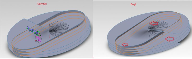

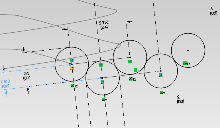

I managed to get driveworks working somewhat. I am now having a problem that I have tried to fix in every way I know. Before running driveworks my sketch13 is fully defined, and the dimension for the distance between the top row of circles corresponds to the linear pattern they follow, so if I change this dimention the distance in between each circle changes also, exactly like I expect (as seen in the first attached picture). However, if I run driveworks to create a model with a different diameter, although it doesnt give me any errors, the sketch stops being fully defined and the top row of circles do not change their spacing. The dimension all of a sudden loses its relations to the other circles and I cant do anything about it. I have tried rebuilding the driveworks database several times, and I have made sure that "add spacing dimension" and "display instance count" were always checked off, but nothing seems to work. The bottom row of circles (in the same sketch but they are a different pattern) have always worked perfectly and were remodled easily with driveworks. If any one has any ideas on what is going on it would be much appreciated.

Sorry about the delay, I've been traveling so I haven't had time to review the part. I posted the part in the SW forums, the solid sweep feature seems to have a bug. I plan on submitting this issue to SW when I return. A member of that forum suggested a work around, I have a few in mind as well. I experienced the same problem with the sketch pattern, it seems to lose its relation when making large dimension changes. This may also be a bug. If so, the solution may be to created each layer individually. You would have to create the maximum number of layers then suppress/unsuppress the ones you want. Do you still need a hand?

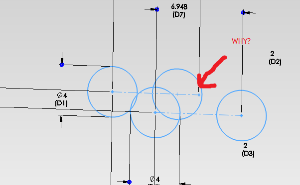

Wire diameter can be changed in small amounts, large amount wreck the relations between the top layer. After some more testing this also failed, changing the wire diameter (with no other changes) by any amount wrecks the relations between the bottom layer now!
Changing slot width by any amount wrecks relations between the bottom layer

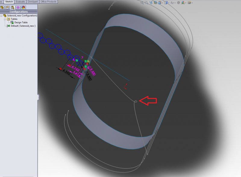

Changing slot length and diameter causes problems (see bug.png)
Changing number of turns causes a bug in the 3D path. (see 3dpath.png) (NOTE: The 3D path is created by "intersection curve" between the slot surface and the sweeped helix)
