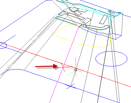

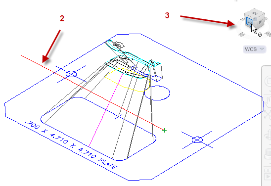

Well I tried to attach a small video here on how to do it in AutoCAD, but the attachment size here is so limiting.
1.Set elevation to .75
2. Draw horizontal line across screen.
3. Go to back view.
4. Point apparent intersection pick angled line first then horizontal line
Pictures didn't show in exact order. Start bottom left (after setting elevation) then go counter-clockwise.

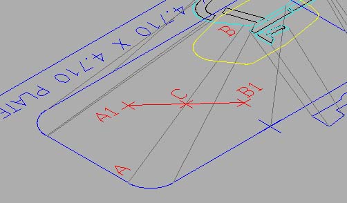

I don't know how you are getting on, but here is a way of constructing a line which gives you what you want. It uses the .XY filter which is a way of getting the XY coordinate from something already in the drawing, and giving a Z of your choice. It works in the view of the posted drawing.
Consider Constraint line AB. Draw a line from the .XY of the Endpoint at A and give it a Z of 0.75 (point A1), to the .XY of the Endpoint of B and also giving it a Z of 0.75 (point B1). This new line intersects the original line at C which is a true Intersection at a Z of 0.75.
