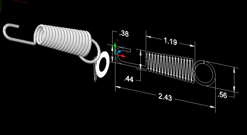

cyter Posted May 2, 2011 Share Posted May 2, 2011 I would also like to know how to dimension objects in 3D.110501072208-62207.zip Quote Link to comment Share on other sites More sharing options...
kencaz Posted May 2, 2011 Share Posted May 2, 2011 You will want to make use of the FLATSHOT command... You can dimension 3D objects but it takes a lot or re-orienting of the UCS and is really not the correct method of dimensioning your models... KC Quote Link to comment Share on other sites More sharing options...
JD Mather Posted May 2, 2011 Share Posted May 2, 2011 You can dimension 3D objects ... ....not the correct method of dimensioning your models... Search Google Y14.41 Digital Product Definition. Autodesk has a 3D Annotation tool at http://labs.autodesk.com Quote Link to comment Share on other sites More sharing options...
