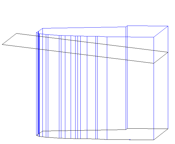

How do I extend this blue object to the upper bent area and then extrude all around it to get that one blue object because I want to see it's area?
Is the object a surface or is it a mix of horizontal and vertical lines?
Or how do I trim this blue object that surpasses this upper surface
When I try "subtract" it says "At least two solids or coplanar regions must be selected."
Turn the top rectangle into a region then subtract. Of couse if you use a newer version you can just grib edit the solid by dragging the edge down to the point you need. :)
Not sure how you would grip edit to that inclined plane, but I would use Slice with Surface option.
Subojbect selection would work a few picks required but that would be one method of doing it. Slice may be quicker in the is case hadn't thought of that. :)

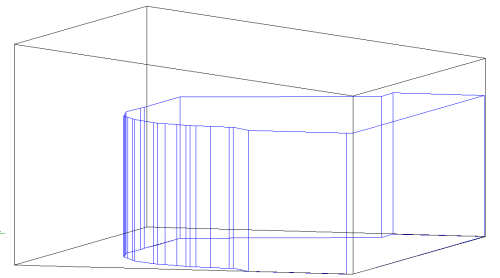

Can you post an example?
A quick and dirty one. Editing the one edge and using a vertex filter.
