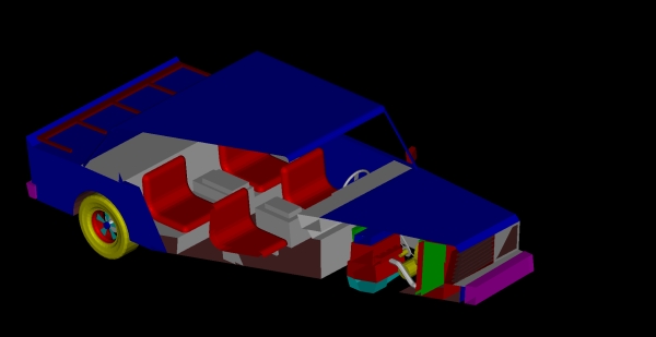

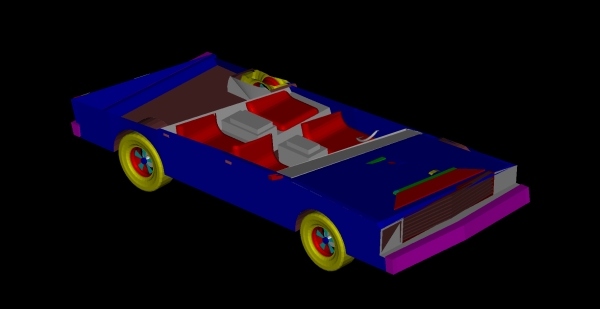

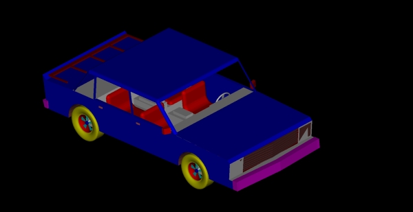

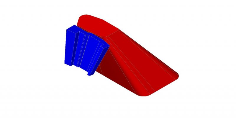

ReMark Posted April 29, 2011 Share Posted April 29, 2011 To expand on what the StyKmaN was saying, this is an example of two solids roughly based upon your geometry. Once you have your solids constructed then you can use either the Section command or the SectionPlane command (depending on your needs) to generate the sections you are looking for. Quote Link to comment Share on other sites More sharing options...

ReMark Posted April 29, 2011 Share Posted April 29, 2011 The solids I created above were done using the Loft command. Other commands for creating soilds are Extrude and PressPull. Look at JDM's signature. Click on the link to his tutorials. They were done using AutoCAD 2007. Quote Link to comment Share on other sites More sharing options...

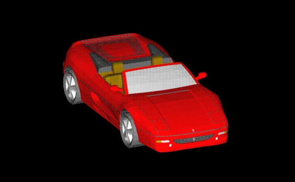

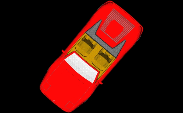

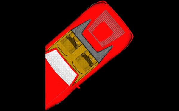

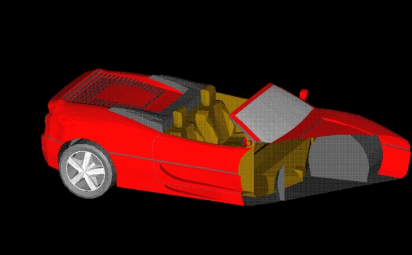

David Bethel Posted April 29, 2011 Share Posted April 29, 2011 David: For those of us not familiar with such programs can you name a couple? Thanks. Remark, The process I use is to: Explode everything into it's native form Convert each entity into a 3FDACE ( or exploded mesh ) From there calculate whether each face needs to be sliced based of the axis and location specified by the user Reform the face so that the no edge protrudes beyond the given value. Sometimes 1 face must be made into 2 faces I limit the input axis to north south east west above and below. It just made my life a lot simipler. This Ferrarri I sliced the west portion off in plan view. Fun but it really needs a well detailed model. -David Quote Link to comment Share on other sites More sharing options...
