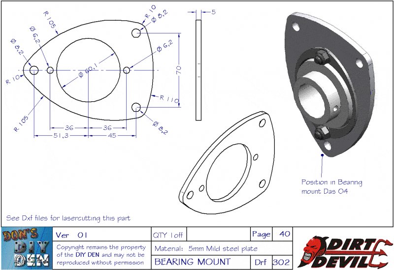

canaanp Posted April 27, 2011 Posted April 27, 2011 Hello, I am extremely unexperienced with AutoCAD, but I desperately have a need to accomplish the following task: I have several dxf files that were provided for laser cutting purposes. I have attached one file as an example. I am able to open the file and choose layout 1 and print. If I choose a 1:1 scale the image is very tiny in the corner of the page. If I leave the settings alone and just print, it is a full page, but the part on the paper is not the correct dimensions. The dimensions are in the gif file I also attached. When I print the dxf file the gap between two of the holes, for example, that should be 70mm is actually like 95 or so. Can someone please tell me how I can make this work? I have acad lt 2004 but also trueview 2011 if that helps. I have not had any luck in either one though. Thanks in advance for any help that is provided. Bearing plate 5mm mild steel.dxf Quote

canaanp Posted April 27, 2011 Author Posted April 27, 2011 The files were provided for laser cutting, however, I will be using a plasma cutter by hand. So what I need is to be able to print this out and cut the shape out to use as a template for marking the steel. So I guess I need it to be 1:1, 1 unit = 1 mm right? I did a linear dimension on the two small holes on the right hand side, and it did say 70, which the gif shows it should be 70mm. If you are able to fix this, can you explain how it is done - I have about 30 more that I will have to correct. Thank you very much Quote

designerstuart Posted April 27, 2011 Posted April 27, 2011 how is this (attached) i have made the paper size A3 and the viewport scale 1' to 1" but i am not an imperial user so don't understand how you got a drawing in mm but scales in inches! (this can be changed too if you need to) i also locked the viewport to prevent accidental changes. all this is easy for you to do if you want to learn! Bearing plate 5mm mild steel ADJUSTED.dxf Quote

canaanp Posted April 27, 2011 Author Posted April 27, 2011 Yes, this is perfect thank you! I could not open with 2004 lt, but I could open it with trueview 2011 and clicked the work tab, plot and it worked straight away with no changes. The measurement was 70mm as it is supposed to be - Thank you! Now, what is the secret? Quote

canaanp Posted April 27, 2011 Author Posted April 27, 2011 OMG so simple... I just realized that all I have to do is select the layout tab, select the entire contents of the layout, then hit ch. display locked was already set to no, but it had a custom scale, I changed that to 1:1 and hit plot and it's perfect. Thanks for all the help! Quote
