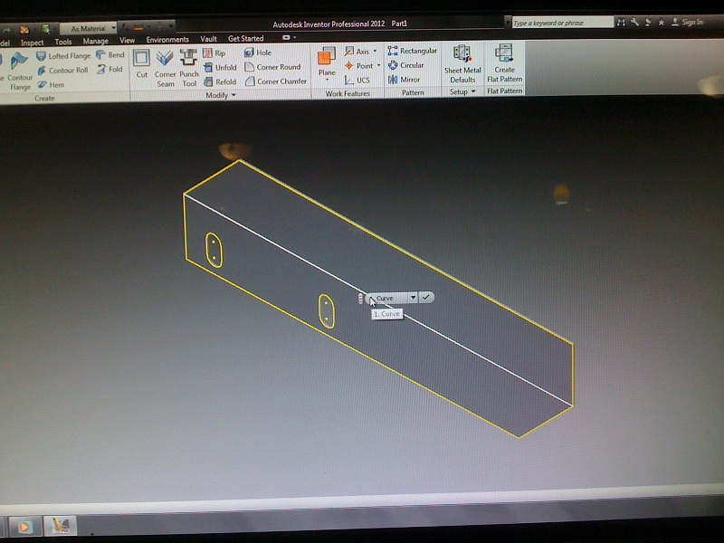

guilty by design Posted April 27, 2011 Author Posted April 27, 2011 I downloaded a trial version of inventor and im learning some of the commands and whatnot are a lil different. But where im hung up now is the bend command. It says to sketch a line on the face i want to bend and make sure it terminates at the end of the faces (i have that). I click fold and select the bend line i want, but no matter what i do it says it cant make the bend. Ive watched the video on autocads wiki help page and followed it exactly, but it still wont allow me to put a simple bend in the sheet. Quote
JD Mather Posted April 27, 2011 Posted April 27, 2011 That is not how to bend sheet metal. Use the sheet metal tools to model in finished form and then have the program unfold it for you. The finished form is the source of truth. Attach a sketch of what you are trying to do. Quote

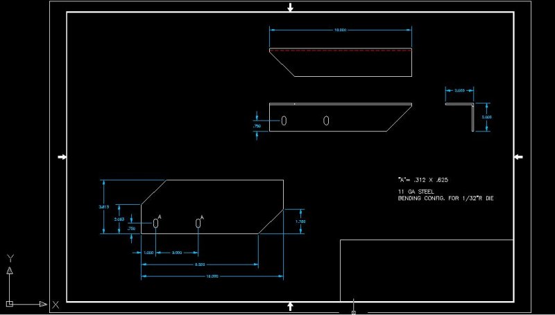

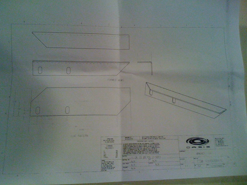

guilty by design Posted April 27, 2011 Author Posted April 27, 2011 Heres the drawing im trying to replicate And heres where im at with the drawing The blue line is the line the program tells me to draw indicating where i want the bend. JD what your saying is i need to draw the part as it will be formed and then flatten it to get my 2D image? Quote

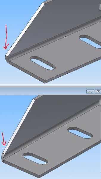

JD Mather Posted April 27, 2011 Posted April 27, 2011 Here are a couple of solutions. Notice the differences in the chamfered bend corners - AutoCAD users (particularly 2D) miss these subtle differences in sheet metal. I couldn't read your dimensions - so I just made some up. Edit Sketch1 to see that it is simply two lines, then use Countoured Flange to create the part. Solution 1.zip Solution 2.zip Quote

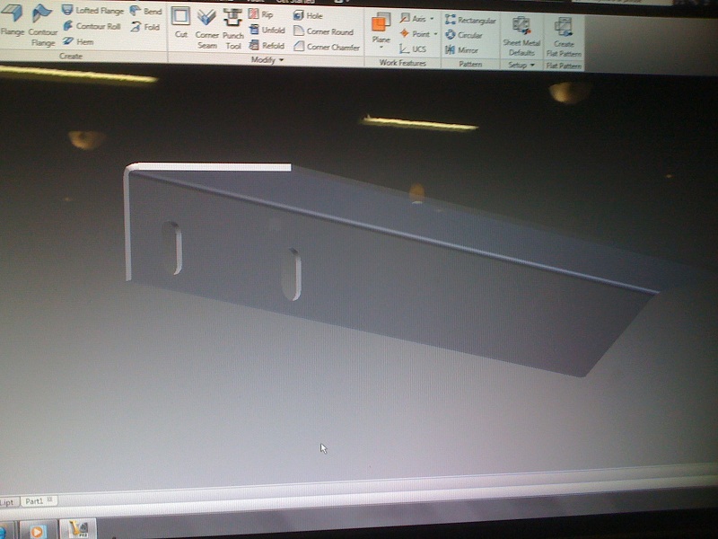

guilty by design Posted April 27, 2011 Author Posted April 27, 2011 Eureka! I think my problem was in extruding the part instead of using the face feature in the sheetmetal toolbar. I can bend the part now. One thing i did notice tho is i didnt see a way to indicate how thick i want the part in the face setting. Quote
JD Mather Posted April 27, 2011 Posted April 27, 2011 See the Sheet Metal Defaults icon - upper right corner of your screen - that sets the material thickness. Quote
