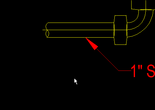

Has anyone ever gotten this Osnap to work? Whether I try to rotate something or draw a line, the Parallel icon comes up over the object I'm trying to snap to, but then the command line says "No endpoint found for specified point. 2d point or option keyword required".
Works here, I use it for lines, never tried with rotating. With osnaps set, start line, pick a point, hover over other line until parallel is aquired, move cursor until you see rubberband line, pick again.

eg.
oh, the rubber band line. You have to move away from the object again. Doh!

Alan, the animated screen cap made it very clear as to how this confusing item works. Thanks!
You're very welcome. That one is hard to explain, so I figured it'd be easier to just watch someone do it.

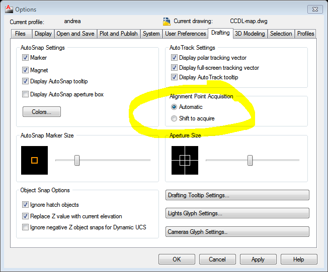

Check preferences>drafting>alignment point acquisition is it "shift to acquire" or "automatic"?
If it is shift to acquire, press shift when you're hover the reference object and the parallel icons appear. A small cross will appear on the reference object, then once you move the cursor in a parallel position the rubberban should appear.
