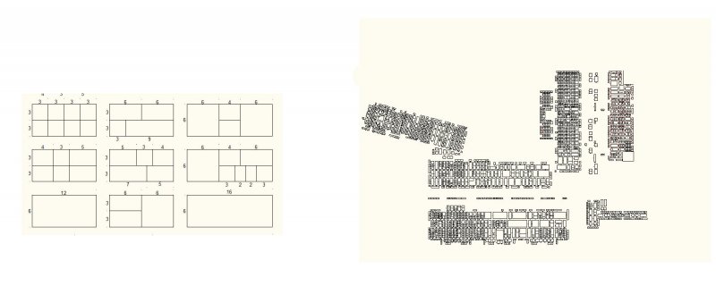

gadgetjay Posted March 31, 2014 Posted March 31, 2014 Thanks Remark for a quick response - 'QDIM' is ok for '1 block' but as there are so many spaced apart this also give the spaces in between and only works if the in rows, there are about 3000 of these blocks . see attached I would like to be able to select all the 'bottom' boxes and choose bottom dim then left and choose left and so on. Quote

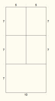

djx084 Posted April 1, 2014 Posted April 1, 2014 (edited) I need help, I have this lisp "PDIM", but it is necessary that all dimensions are inside the contour and not like the picture 1, can this be done? thank you all in advance lisp PDIM : http://www.sendspace.com/file/3txh6a picture 1 : http://www.sendspace.com/file/p3upgc picture how it should look : http://www.sendspace.com/file/y9q7ra Edited April 2, 2014 by djx084 Quote

djx084 Posted April 2, 2014 Posted April 2, 2014 (edited) Does anyone have a solution for the modified PDIM lsp file???? if anyone can modified the dimensioning on the inside of the some object?????? Edited April 2, 2014 by djx084 Quote
