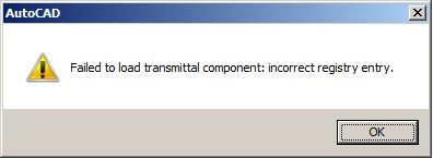

Why can't I e-transmitt, I get this error....

Looks like something got corrupted or maybe was not installed properly. I would run a Repair.
Actually, have you tried simply shutting down and restarting Autocad? If that doesn't work, then run a Repair.
Yeah I did, but that is of no help.
Maybe I should run a repair, that should be no problem.
Thanks for the reply!
According to Autodesk site it may be caused by registry cleaner.
http://forums.autodesk.com/t5/AutoCAD-Civil-3D/E-Transmit-failed-to-load-transmittal-component-incorrect/td-p/2518259
Here are the proper Uninstall/Reinstall instructions. If repair doesn't work.
http://usa.autodesk.com/adsk/servlet/ps/dl/item?siteID=123112&id=10243968&linkID=9240617
