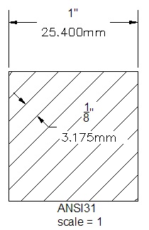

ACAD.PAT and ACADISO.PAT are both based on IMPERIAL inches
ACAD.PAT
*ANSI31, ANSI Iron, Brick, Stone masonry
45, 0,0, 0,.125
ACADISO.PAT
*ANSI31,ANSI Iron, Brick, Stone masonry
45, 0, 0, 0, 3.175
.125" = 3.175mm
If you draw in feet vs inches, change HPSCALE by a factor of 12
If you draw in meters vs millimeters, change HPSCALE by a factor of 1000
ACAD.PAT
45, 0,0, 0,.125
ACADISO.PAT
45, 0, 0, 0, 3.175
.125" = 3.175mm
[ATTACH]27019[/ATTACH]
