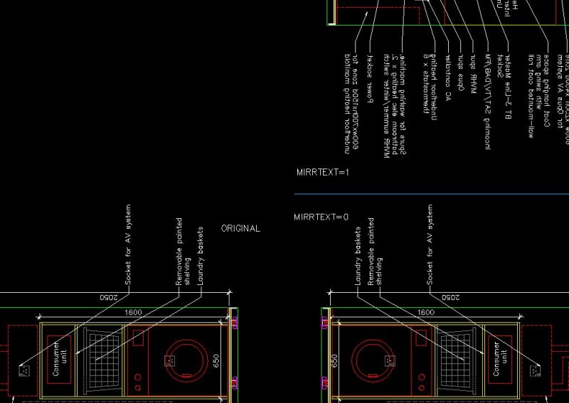

designerstuart Posted April 13, 2011 Posted April 13, 2011 (edited) hi all i want to mirror a drawing wholesale, but its layout means that i have text at various rotations..... see pic. there's a plan in the middle, with elevations around like a net. i know the variable MIRRTEXT but this won't solve the problem, because i want the text to flip to the new location as it does, but also mirror its orientation, if that makes sense. currently i can only mirror everything as if it were a block (backwards text) or as a 'clever' autocad user (upside-down text). if it doesn't, i'll post more pics. cheers. Edited April 13, 2011 by designerstuart more clarity?! Quote
designerstuart Posted April 13, 2011 Author Posted April 13, 2011 okay so maybe another image will help?! original on left, mirrored on right. top one text is backwards, bottom text is upside-down is there a way that this will work? note it works fine when mirroring text left to right, just top to bottom that causes problem. and ignore the dims, i have a wonderful DIMFLIP lisp! Quote

designerstuart Posted April 14, 2011 Author Posted April 14, 2011 GLEN yes here's a dwg - not much to it. i'll post a screenshot too. MIRRTEXT.dwg look at the red boxed bit. it's an elevation. notice how when the entire dwg is mirrored, its text is either backwards or upside-down. mirror line drawn, if it helps. i would have thought that when you mirror text, there is a variable for its orientation to be mirrored, too. i understand that the mirrtext=0 is very useful, but so would this be! and knowing autoCAD, where everything is controllable, i expect it's in there somewhere. just need to know what it's called! thanks all Quote

dbroada Posted April 15, 2011 Posted April 15, 2011 As far as I can see your small drawing is working a expected, what are you trying to achieve? Quote
nestly Posted April 15, 2011 Posted April 15, 2011 dbroada said: As far as I can see your small drawing is working a expected, what are you trying to achieve? Yeah, MIRROR and MIRRTEXT appear to be working as expected, but I see what you want to do. You want the vertical texts to continue to read clockwise after mirroring, but that would require a command that both mirrors and rotates vertical text at the same time. I'd just change them manually if there's only a handful, otherwise I'd probably use QSELECT on the mirrored objects to delete all the texts with 90 and 270 degree rotations and then use QSELECT again to copy all the 90 and 270 texts from the original to the mirrored location. Quote
dbroada Posted April 15, 2011 Posted April 15, 2011 or use QSELECT and change their rotations from the properties palette Quote
