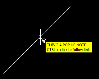

Hello! I was wondering if there is any way that you can add a Pop up comment in AutoCAD like you can in Excel. I am currently drawing circuit diagrams and need to have the pole numbers pop up only when I hover over the symbol. All the pole numbers are unique, so a block will not work.
I've tried looking everywhere online.. to no avail! :x
Thank you in advance!
You can add a hyperlink (Ctrl+K), and when the cursor is hovered on the entity, the message will appear.
The actual link can be to Model Space or something else simple.
Thank you soo much! You have restored my sanity!! :)
