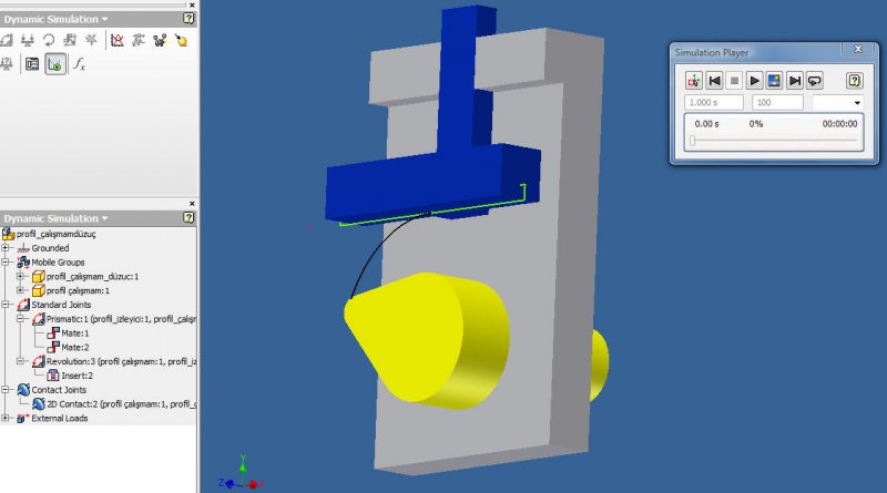

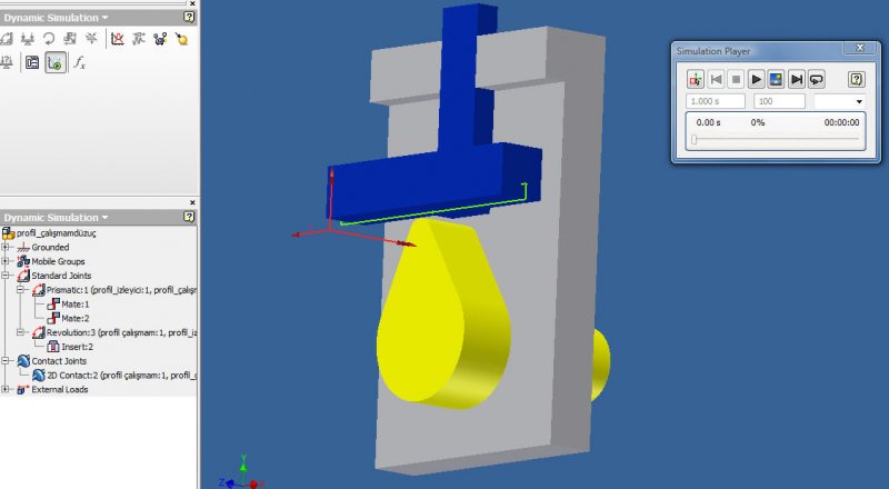

ses4 Posted April 8, 2011 Posted April 8, 2011 Dear Sir; I am working a manufacture camshaft plant in Turkey.Could you help me please for inventor dynamic simulation. I want to do a simular simulation like a following adres. But I couldn’t yet.Because I have a mistake defined to joint.Normaly flat follower has to move together by cam.But it has no moved.Can you prepare this simulation for me or explain my mistake. Best regards… Quote
JD Mather Posted April 8, 2011 Posted April 8, 2011 ses4 you have posted in the wrong forum. You should post this in the Inventor forum. Zip and attach your assembly there. I do not see a Spring/Damper/Jack Force (expand your External Loads node in the browser) Quote
ses4 Posted April 10, 2011 Author Posted April 10, 2011 Dear JD Mather thanks for your answer.I want to converter cams profile value roller follower to flat follower but I did'nt yet.Could you help me please. Quote

ses4 Posted April 10, 2011 Author Posted April 10, 2011 (edited) Drawing1.dwgFetching info... JD Mather said: Do you know the desired displacement profile? please help me? http://rapidshare.com/files/456862919/body.ipt http://rapidshare.com/files/456862920/flat_follower.ipt http://rapidshare.com/files/456862921/sablon.ipt http://rapidshare.com/files/456863062/flat_follower.iam http://rapidshare.com/files/456863133/Sablon.XLS Edited April 11, 2011 by ses4 Quote
JD Mather Posted April 12, 2011 Posted April 12, 2011 You spreadsheet list of coordinates is not a displacement diagram. And it appears to have been generated for a round follower. What is the rise, fall, dwell and acceleration profile for your cam? (you can create this using the Cam Generator even though your follower will not be round - post a screenshot of your displacement diagram) Quote
