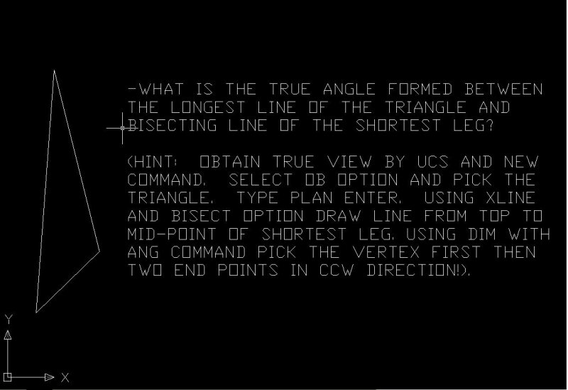

Help I dont know how to do this.. :S
How do i do this??

The instructions given are in conflict, one part says to bisect the angle another says to draw to the mid-point of the shortest leg.
You need to know what is truly needed first or draw it both ways and give both answers.
Might the diagram be of a 3D figure :?

I assumed it is based on the hints/instructions given. But one part says to bisect the angle and another part says to draw to the middle of the short line, the OP needs to know which they want.
You need to read the instructions carefully.

Ambiguous, IMO
If you forget the "hint", the angle between the longest line and the bisecting line is >> 90° - angle between longest line and shortest line, assuming that the bisecting line is perpendicular to the shortest line. The "hint" is not entirely clear to me.
A hint...it says nothing of bisecting an angle. It says to bisect the shortest line.

Have you tried the xline, bisect option and tried to bisect the short line? The instructions are bad. And if you do draw between the vertex and the middle of the line you will get two angles, which one do they want?
Yep, I have no which angle they want, and the "hint" does nothing but further muddy the water IMO.
Pretty much what is asked is to rotate the triangle (3D) around to the Plan View (new ucs), then draw a line from the vertex of the two longest lines through the midpoint of the shortest line, then determine the angle between the 'bisecting line' and the longest side.

If I try and use the Bisect option in Xline, it only offers to bisect an angle. But then why does the hint go on to say to the mid point of the line? Nothing about bisecting there.
But if you want to bisect an angle and go to the midpoint of a line, then the only plane figure that I know matches up with that is an isosceles triangle, or an equilateral (equiangular) triangle. The given figure is not one of those, so must be rotated in 3D until it matches up. It did say at the beginning about a True angle, so implicating that the given figure did not lie in the 3D plane of the triangle.

The hint is confusing to us because we are not privy to the information discussed before the assignment, as is apparently the situation with the OP.
Speaking of the OP, go back and check out their posting history. Very dissapointing level of response, especially in responding to requests for further details. Seems to me a series of requests for completed homework assignments.

Not so fast. Without the drawing you have no idea which leg is the longest. You can easily draw that to have one of the other legs be the longest.
My triangle is very close to the one shown....you have overlooked the instructions on changing the view to plan.

To me, it is very curious that the sides should be referred to as the longest and the shortest. Why not mark the vertices by letters (A, B and C), and designate the sides accordingly?
There is more to this than the OP is letting us know.
