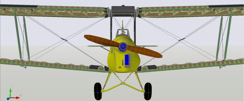

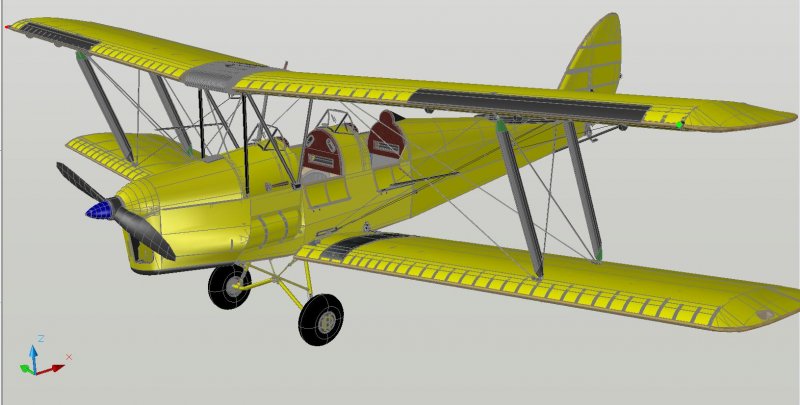

peregrin8r Posted April 6, 2011 Posted April 6, 2011 Hi. This is my first post here. I am self taught on acad 2008, and have created a complex 3d drawing over the last year or so. But I need it to be represented in a mechanical drawing. I tried flatshot, but this is not true to form. Is there a way to do this? (an easy way) Quote

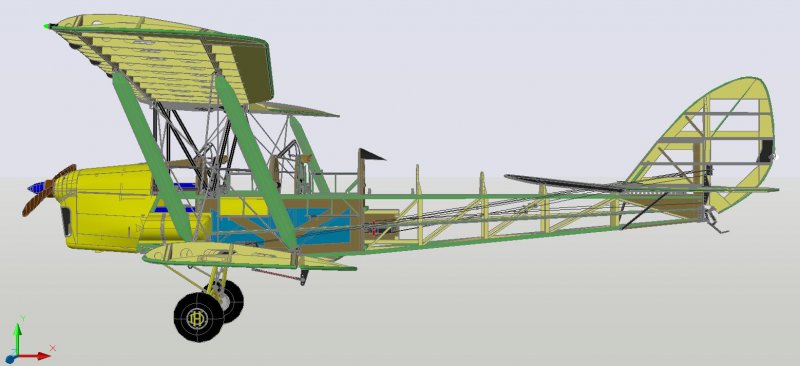

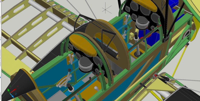

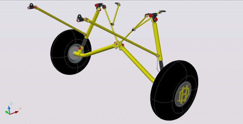

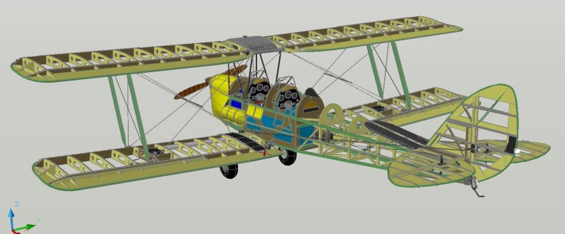

peregrin8r Posted April 6, 2011 Author Posted April 6, 2011 Here are some pics of my work. It's a 1/6th scale DeHavilland Tiger Moth. I originally made a 2d draft of this, but have since made many changes in 3d without a record of the changes. I thought maybe it would be easier to convert back to 2d than it appears to be. Quote

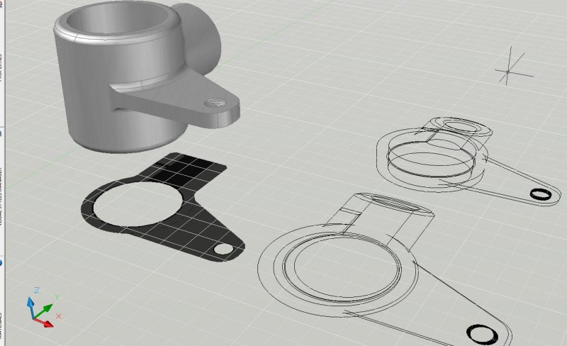

peregrin8r Posted April 6, 2011 Author Posted April 6, 2011 I also tried Flatten which did the same thing. It projected down from a camera view, not straight down from each point and vertice which is what I am looking for. Forgive me if I'm not using the right terms here. Also, if I use section plane, am I going to have to do multiple sections, because that seems a daunting task. Quote

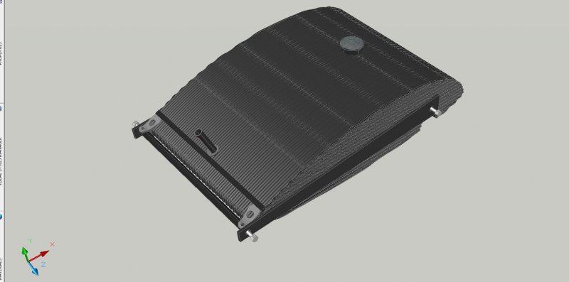

peregrin8r Posted April 6, 2011 Author Posted April 6, 2011 No, there is no view cube in 2008. This is a small part I made just to practice on. The two projections(is that the right term?) to the right are what I've been winding up with. The shadow under the part is an accurate representation of what I'm trying to accomplish(sans shading). Quote
ReMark Posted April 6, 2011 Posted April 6, 2011 I believe I know exactly what happened. You used FLATSHOT in the orientation pictured above (an isometric view). If you switch to a Top down view do the images appear more like you imagined they would? FLATSHOT should be used in the orientation you wish to see your final 2D block. You should have been looking at your part in a Top view. Quote
