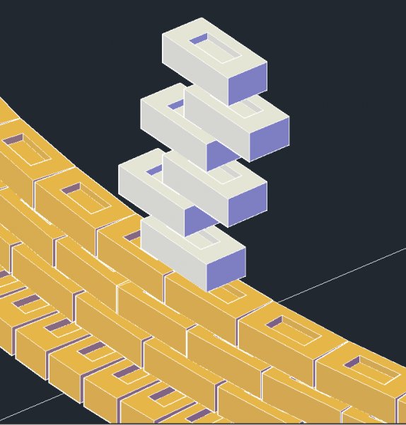

The attempt was made ​​with a 3D solid. I did a brick after a "POLAR ARRAY", "PATH ARRAY" and "POLAR ARRAY" again!

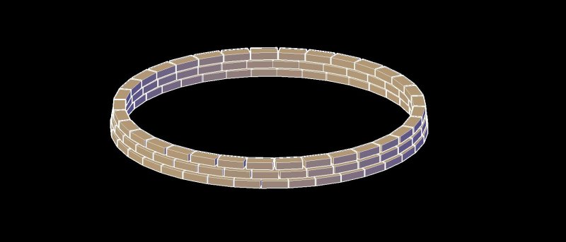

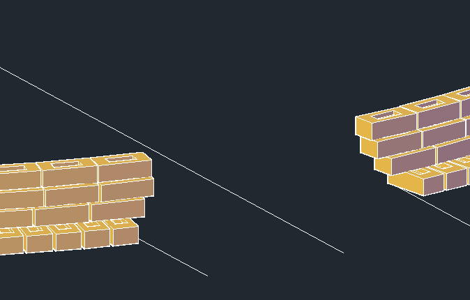

My initial attempt using a single size brick. I used the 2D Polar Array command. Each row of bricks above the first is pulled back from the edge 3/8". There is a 3/8" gap between rows for the mortar. I think it could be done this way but it is very time consuming. It also requires a bit of trial and error.
I have no desire to finish this off. It just doesn't hold my interest. And if one were to do it using my approach I would have to say that each row of bricks would have to be tilted back towards the center of the oven to give it a more realistic look to the construction based solely upon the image provided by the OP in post #1.

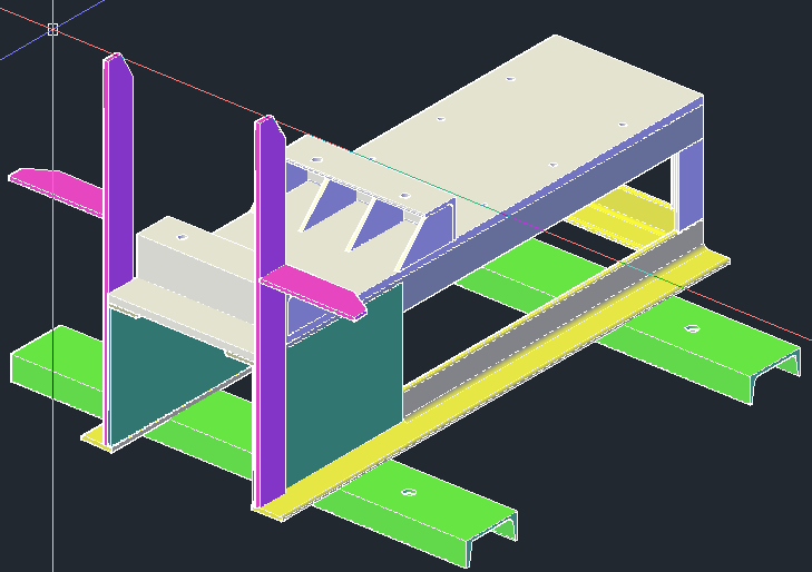

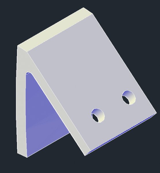

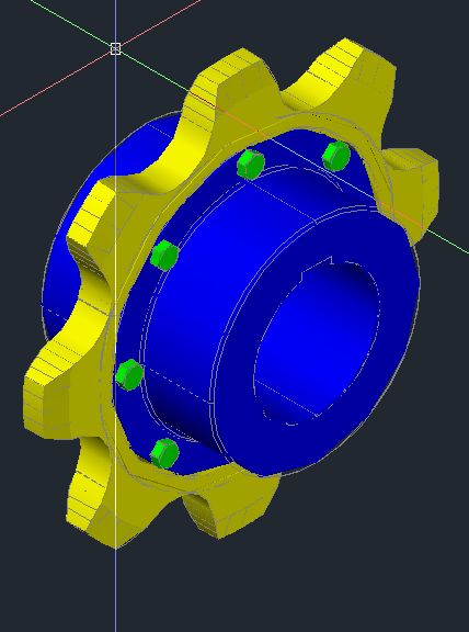

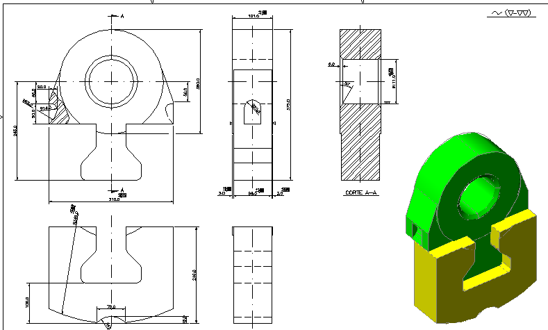

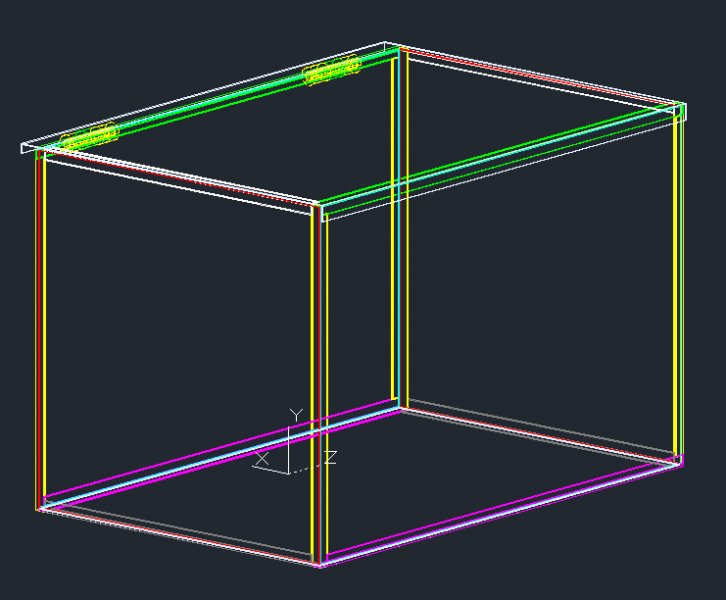

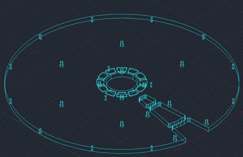

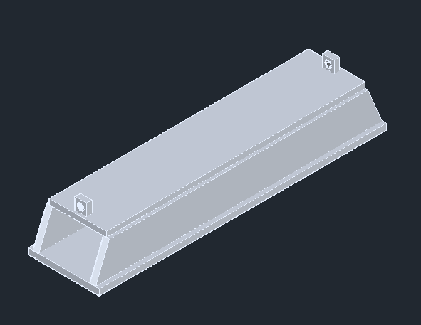

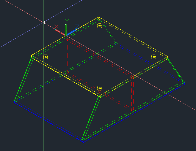

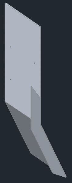

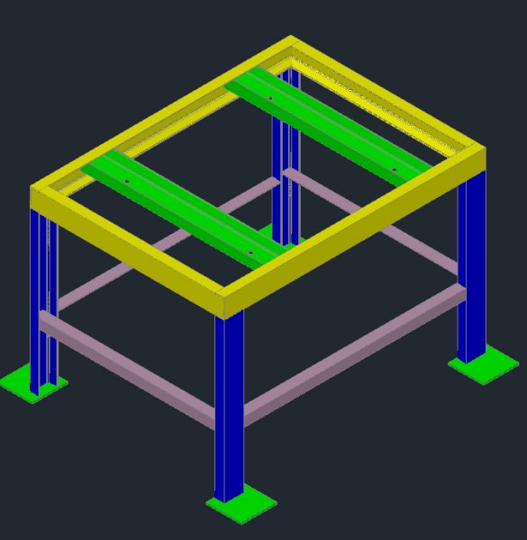

Here is what was requested:
Do not put a degree of complexity because each has been difficult, each in his time. Some of what I've done.
As I said my experience is higher in the metallic structure.
I appreciate your time with this post
It was exactly what I saw when I started. It will be very difficult, but ... would be very close to real!

As the bricks are inclined into the oven, I did not find this feature in the command "POLAR ARRAY"

Your brickwork looks a lot like mine in that you haven't tilted the brick face in each row. If you continue this way you won't have a true representation of your charcoal oven.

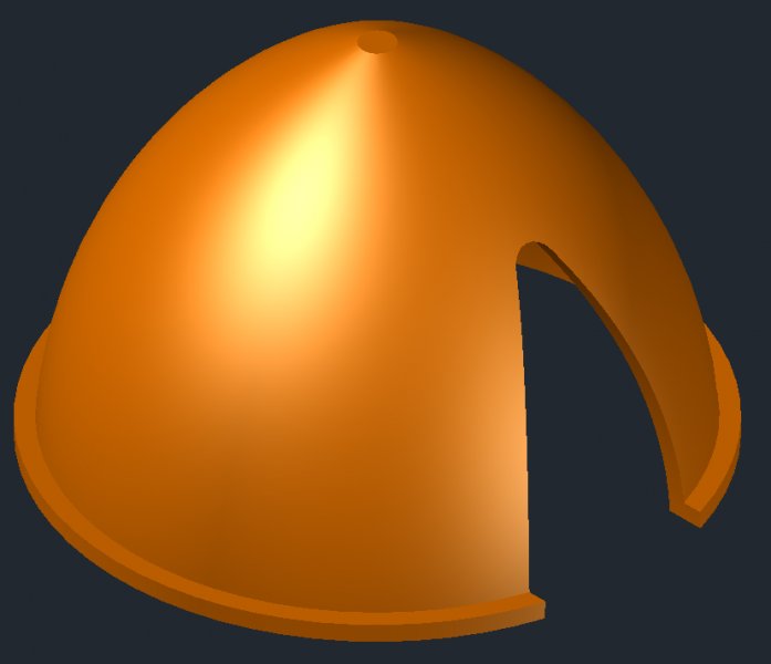

Couldn't agree with you more. What if we abandon the individual brick concept and go for a lofted solid (then shelled)?

If I did what you did as a closed furnace and then create a solid BOX to the door, I can not subtract the BOX "POLAR ARRAY" ever created.
Ok, Ok I'll do a study with this suggestion.

Sorry for the delay ... Now the most difficult part texturing .. if anyone has any tips .. will be very welcome!
