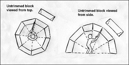

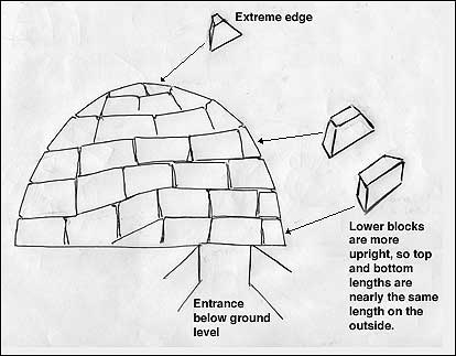

ReMark Posted April 5, 2011 Posted April 5, 2011 An igloo uses blocks while the oven the OP provided the image of uses bricks. I think he will find it tough going. But speaking of bricks, during a major reconstruction of our city's Main Street workmen unearthed a 100" double-brick wall sanitary sewer dating back to the late 1800's. How's that for old world craftsmanship? Quote

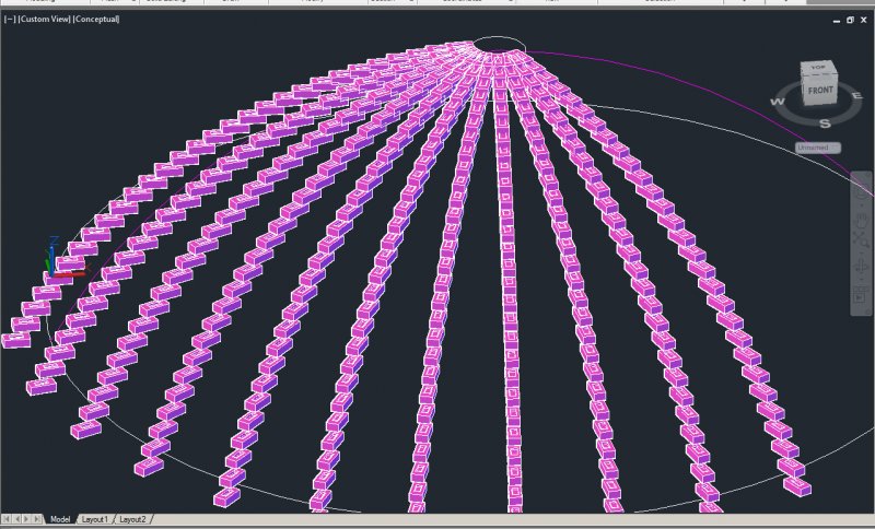

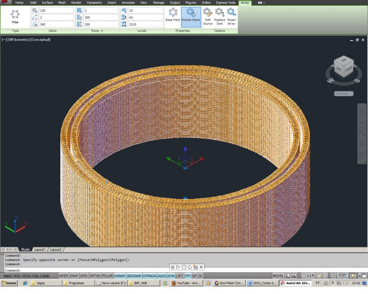

thy Posted April 6, 2011 Author Posted April 6, 2011 Again, I'm not a mason and I'm sure this wouldn't do as shown in the video, but the bricks could be 3D blocks which could be positioned along the profile with MEASURE, and then ARRAYed from the top. http://screencast.com/t/5EVms0lf2Ziq Thanks for the suggestion ... made me think better ... MEASURE I tried the command but not worked very well! I made the block with brick and using the MEASURE command was not aligned. So, I used the command "PATH ARRAY"to distribute the bricks in the Z axis. As the image below: Note that from the top of the bricks did not shut down and the addition of bricks in the command "POLAR ARRAY" causes the computer is very slow ... I say, undermines the work and editing. Another failed attempt to make the oven ... Thanks to all who provide the time to help me! Other suggestions are most welcome Quote
