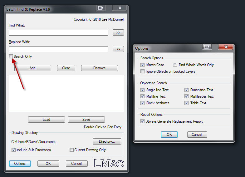

BlackBox Posted April 4, 2011 Posted April 4, 2011 I do not know of any VBA routines that accomplish this, but an excellent LISP routine is Lee Mac's Batch Find & Replace Text. Quote

RickyD302 Posted April 21, 2011 Posted April 21, 2011 The Find and Replaced by Lee Macs does just a search. Quote
