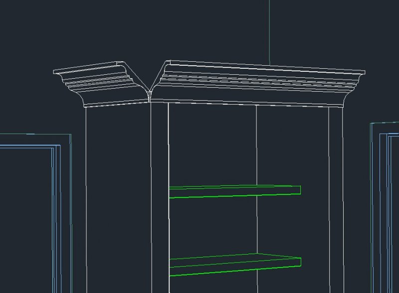

hi,
how can i join these 2 pieces of crown moldings?
ive created them in polyline and then extruded them
thanks
s

Hi Remark,
thanks for your help, i was not able to do that
i do have the profile, can u pls explain step by step
thanks

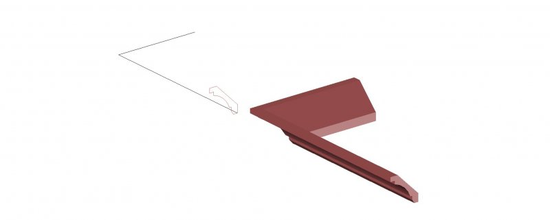

Draw a right angle polyline.
Locate your crown moulding profile at one end.
Extrude this profile along the polyline path.
Result:
You will get a nice sharp, well-defined corner at the bend. Trust me on this.
