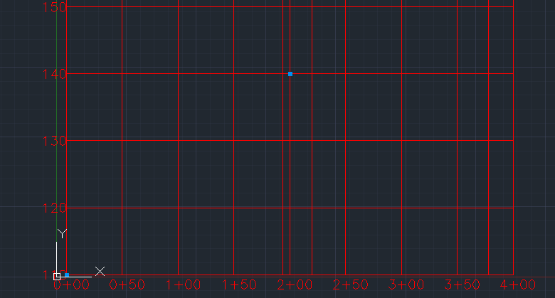

gowinmodi Posted September 18, 2012 Posted September 18, 2012 Remark, please can you check may image for plate-1 ? Thank you Quote
ReMark Posted September 18, 2012 Posted September 18, 2012 Other than a couple of missing grid lines it looks OK to me or at least what I can see of the image above. Quote
gowinmodi Posted September 18, 2012 Posted September 18, 2012 Remark, I just get image from Car5858 post. it look different than me . Quote
ReMark Posted September 18, 2012 Posted September 18, 2012 The grid and spot elevations look about the same to me. What looks different to you? Quote

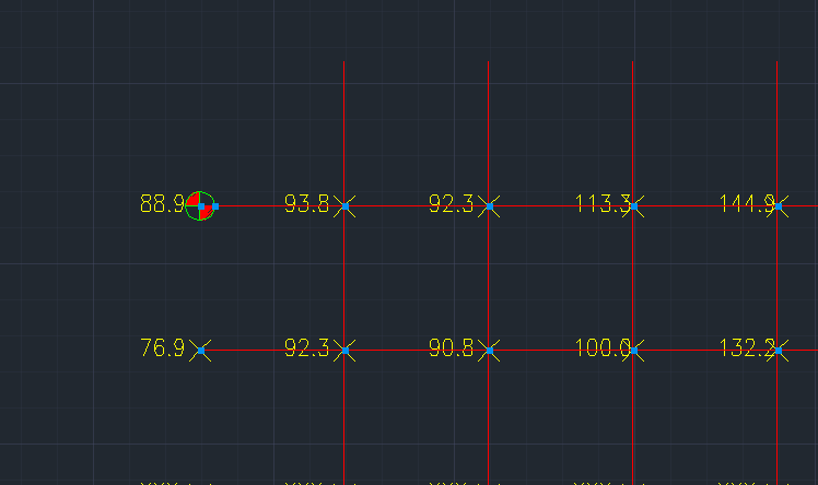

gowinmodi Posted September 23, 2012 Posted September 23, 2012 Remark, I need your help to understand in civil drafting plate-1. on page 16 Point 4 and point 5 ask me to find delta angle and length. can you guide me how to find delta ? Thank you Quote
ReMark Posted September 23, 2012 Posted September 23, 2012 If you have constructed the geometry you can use AutoCAD to obtain the delta angle and length of arc. Quote

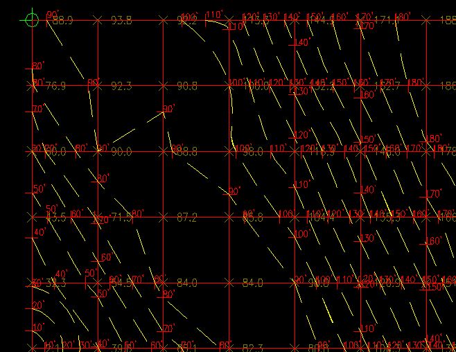

gowinmodi Posted September 26, 2012 Posted September 26, 2012 Remark, Thank you for explain me. I just start my plate-3. please can you check my plate -3 image for am i going on right direction ? Quote
ReMark Posted September 26, 2012 Posted September 26, 2012 Looks like you are on the right track. Did you receive as part of your course materials any other handouts explaining what is required here or how it should look? Have you, like I asked, contacted P-F regarding the instructions for Plates 3 and 4? Quote
