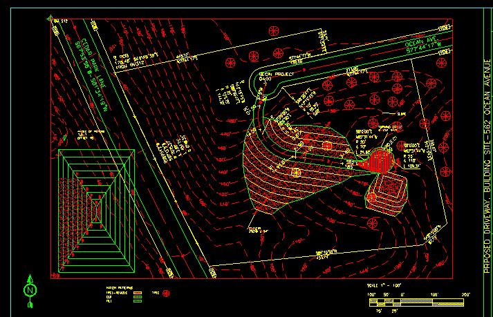

I am working on Plate 2 of the civil drafting project for Penn Foster..I am on page 19 cut and fill part...I do not understand how to do cut and fills...I am still awaiting my questions to be answered on how to do these for Problems 22-14 and 22-15 in the Civil Drafting Study Guide. I have read the materials on pages 19 and 20 in the study guide a number of times and I still seems to be stumped. I am hoping someone can post an image of plate 2 and/or tell me how to get going on this...
PLEASE AND THANK YOU!!!!
Look at previous posts in this thread many of your questions have been answered.
I have looked at all of the posts. Can you at least tell me which ones you are referring to, as the posts I am looking at are not referring to plate # 2 unless I am missing something.
Plate 2 is basically the same as plate 1 with the cut and fill added.
thank you! I just am having a brain block to the cut and fill part of it. I have everything else done on this plate but this...Thanks again...Want to keep working through the weekend and this helps tonnes....
