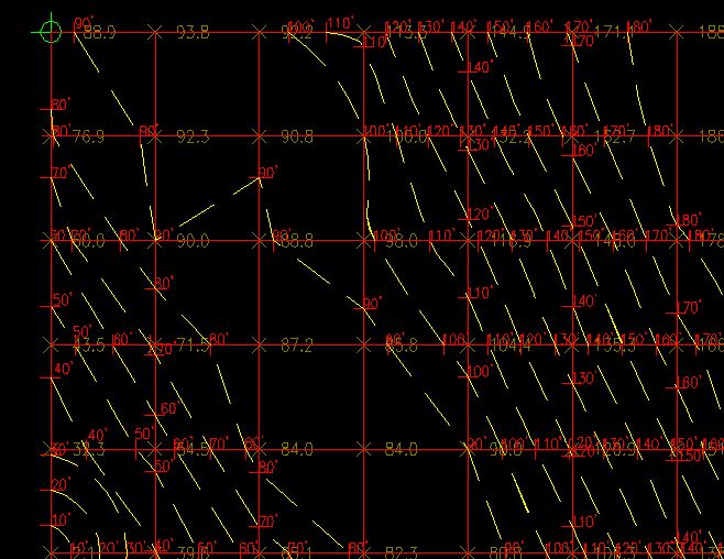

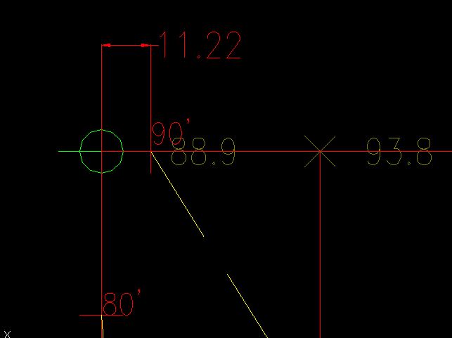

Car5858 Posted April 4, 2011 Posted April 4, 2011 That PDF help remind me what I did. I used example 2 bottom of page 12. Some of the info from the first example is also used. As you read through the instructions write out a math equation. For instance: 93.8 – 88.9 = 4.9 x 10 = 49 50 / 49 = 1.0204082 1.0204082 x 11 = 11.22 11.22 is the distance to the right of the benchmark. You will have to perform this calculation for each spot elevation. Just use the same formula. Do one row at a time from table 3 page 10. Remember that even though the row in the table is vertical, on the drawing row one is horizontal. This is what the couture’s should look like. is what I remember most while doing this. 1 Quote
Autocadstudent Posted April 4, 2011 Author Posted April 4, 2011 car5858 i gess am not asking the right question. i got the calculation you posted. the 11 is from 90-footcontour-88.9=1.1 (11). now that i see the picture, the real question i have is; the 100', 110', 120' east of the 90' on your image, is that because page 8 says 10-foot contour intervals? i feel am asking dumb questions. sorry. Quote

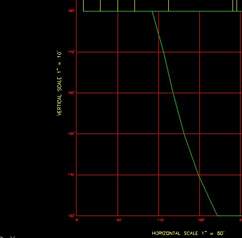

Autocadstudent Posted April 6, 2011 Author Posted April 6, 2011 Hey guys i have been working on this, day and night , because the end is near. Am about to start plate 3 page 21. it says to use vertical scale of 1"=10' and horiz. of 1"=60'. does it mean that for every inch of the drive way am placing it 10' longer? what is the best way to start this driveway profile and section A profile. Please help thak you. Quote
Car5858 Posted April 6, 2011 Posted April 6, 2011 Autocadstudent said: it says to use vertical scale of 1"=10' and horiz. of 1"=60'. what is the best way to start this driveway profile and section A profile.Please help thak you. It means each inch on the drawing will be 60' Horiz. Every inch in elevation will be 10' Quote
Autocadstudent Posted April 6, 2011 Author Posted April 6, 2011 Car5858, Am looking at the image and still don't get it. i have a hard time starting somenthing but when i get i get it. if the driveway profile starts at the centerline. can i copy it from my plate 2 and scale to 10' vertical and 60' horizontal? are those red lines the grid lines? i see the 130 going up by ten' and the zero to 60'. are those the grid lines from the first drawing? am sorry for asking this kind of question. Quote
Car5858 Posted April 6, 2011 Posted April 6, 2011 Ask this question first, what is the elevation of the finished driveway. A It will be the same elevation as the POB (point of begining) of the driveway. The green line at the top of the attachment in post #29 is the drivway. Think of a vertical slice right down the middle of the driveways centerline. Add your station locations above the drivway (that is the yellow marks) and fill in the information required. Remember that you have conture lines placed every 10 feet. This is the vertical scale grid, on the drawing this will be equal to 1 inch. That is why the vertical scale is 1"=10'. The same method is used for the horiz scale, you will be placing a grid line every 60' the actual measurement will be 1" on the drawing. This is a distorted scale and is suposed to mak caulaciting cut anf fill materials easier. This clear up the question for you? Quote
Dana W Posted April 7, 2011 Posted April 7, 2011 Simple answers to help conceptually. The 10' contour line interval represents a 10 foot change in elevation (altitude) as measured from sea level as taken in the field. The plan view horizontal distance between the contour lines on a drawing can be all over the place no matter what the vertical distance is, as you see by your drawing results. If you were to look at the contour lines in an elevation view, they would be straight and perfectly horizontal, spaced 10 feet apart. In some contour maps, the scale is so small that the contour lines can be seen to actually define the shapes of hills and valleys as viewed from high above. Road and street and driveway profiles are usually drawn in a skewed scale, in your case 1:10 x 1:60, so you can draw 500 feet of road at a large enough scale to see details and as mentioned above to make it simpler to calculate working costs (but I have no idea how throwing more math in there might help any:lol:). Quote
Autocadstudent Posted April 7, 2011 Author Posted April 7, 2011 so when i draw a 1 inch line it will represent a 10' line right? Quote

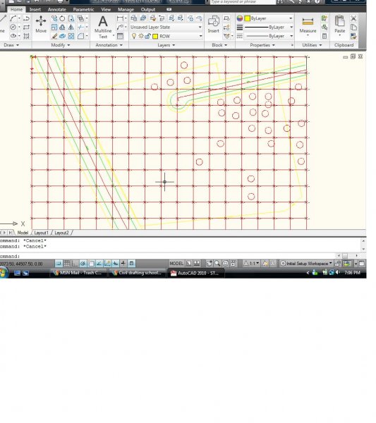

Autocadstudent Posted April 7, 2011 Author Posted April 7, 2011 this is what i got so far: every grid line i placed is 1" long (the drawing very small compard to plate 1 and 2). the green line is the driveway like you said. i got the lenght from plate 2 and divided by 60. am doing it right? i am so ignorant. \Thank you all Quote
Dana W Posted April 7, 2011 Posted April 7, 2011 Autocadstudent said: so when i draw a 1 inch line it will represent a 10' line right? Yup, but you can draw it full size and scale it afterwards, even in two directions. Somebody else will have to explain that one to you cuz my software is a bit different than yours, not sure I'd get it right. Quote

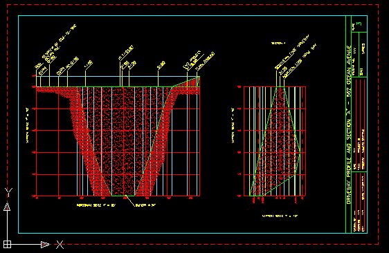

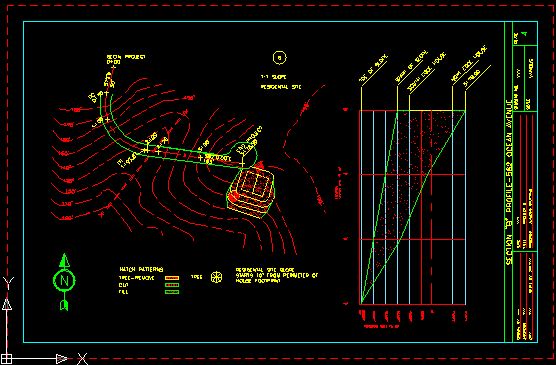

Autocadstudent Posted April 8, 2011 Author Posted April 8, 2011 car5858 can you post the image of plate 3 and 4 please. so i can see what they look like? am not done yet. i don't want to copy and paste the image just want to see it please. Thank you. am sorry for asking again. Quote
Car5858 Posted April 8, 2011 Posted April 8, 2011 Here you go, these are not correct to the letter. I forgot to add slope direction arrows in them:x. I did get a 92% Quote
