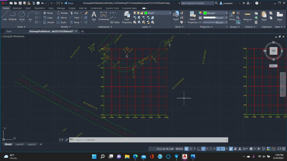

JonnaMcSki Posted March 15, 2022 Posted March 15, 2022 (edited) Can someone tell me Why the 1+00 mark on the top of this graph is past the 1+00 line on the bottom of the graph? I'm referencing the graph I posted below. Edited March 15, 2022 by JonnaMcSki Quote
JonnaMcSki Posted March 15, 2022 Posted March 15, 2022 On 9/26/2012 at 10:05 PM, ReMark said: Driveway profile. Disclaimer: I did not draw this profile and if I did I might have done it differently. Expand Quote
ReMark Posted March 15, 2022 Posted March 15, 2022 Because they started at the ROW and not at 0+00. 1 Quote
JonnaMcSki Posted March 24, 2022 Posted March 24, 2022 I'm trying to line the map of the driveway to the graph to get the points labeled at the top of the graph Like in the image above (plate 3). Is this the correct way to do this or am I supposed to find how many feet each mark is and mark the labeled points that way? Either way I have follow up questions? Quote
JonnaMcSki Posted March 24, 2022 Posted March 24, 2022 (edited) Is this right? Edited March 24, 2022 by JonnaMcSki Quote

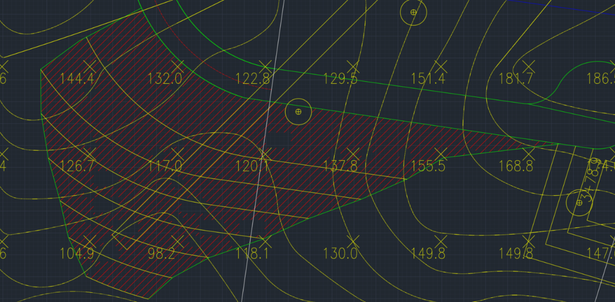

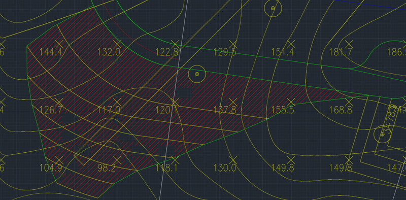

cup2cake28 Posted January 8 Posted January 8 Can someone help me understand the cut-and-fill part on sheet 3, and walk me through what I am missing? Quote
ReMark Posted January 8 Posted January 8 (edited) Have you tried looking at the other threads referencing this very same project? I believe P-F is asking the student to plot existing and proposed elevations on a grid relative to the cut line, in white, pictured above. I assume the above image is from a drawing you created? Sorry, I no longer have a copy of the project instructions, and it is one I am only vaguely familiar with. Edited January 8 by ReMark Quote
cup2cake28 Posted January 8 Posted January 8 I have looked at other threads, but maybe there is a better thread one I have not seen yet. I was under the assumption that I had to make the cut fill and hatching on the drawing itself and then draw it on a separate grid as a sectional drawing. And yes that is my drawing, which is why it looks so bad. I will try to find a different forum for my drawing. Quote
ReMark Posted January 9 Posted January 9 Your drawing looks fine; you don't have to move or repost it. I didn't know if you had borrowed the image from another post. Your description of what needs to be done appears to be correct. Quote
