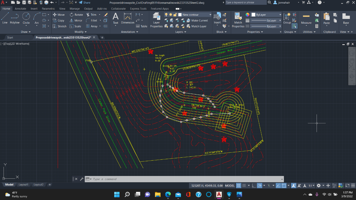

JonnaMcSki Posted March 9, 2022 Posted March 9, 2022 Thank you. I have created the offsets and the points as described in fofa's post. I don't know how to get the part where it says to ......... On 9/7/2013 at 6:16 PM, fofa said: You also need to create a cut and fill layout ratio (the bottom rectangular portion of figure 22-48). The ratio “rectangle” can be created outside of the drawing area and copied/inserted into the lower left hand corner of drafting plate 2. Expand Also are there supposed to have vertical lines on the plain view I have posted? Quote

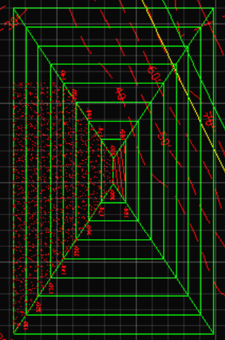

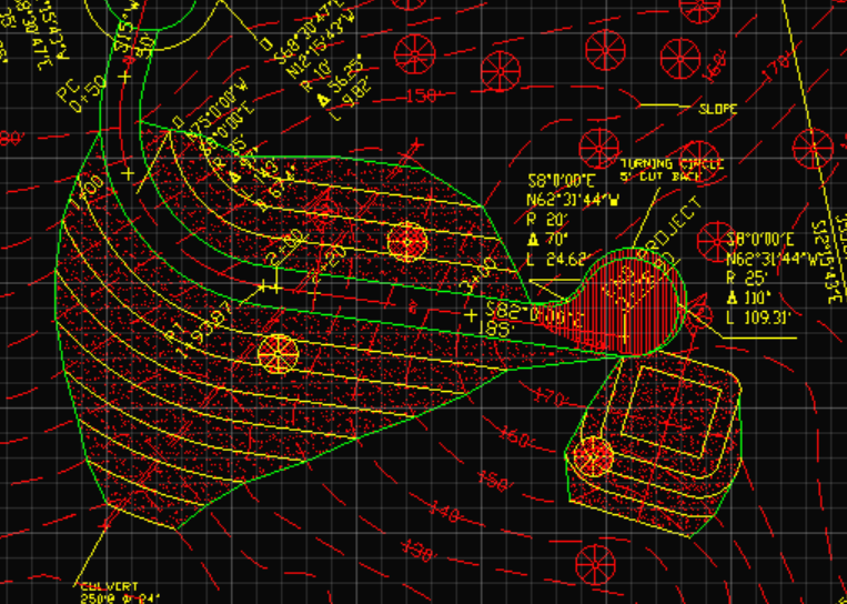

ReMark Posted March 9, 2022 Posted March 9, 2022 Your proposed contours have to be blended into the existing contours. What you see below is acceptable to P-F. 1 Quote

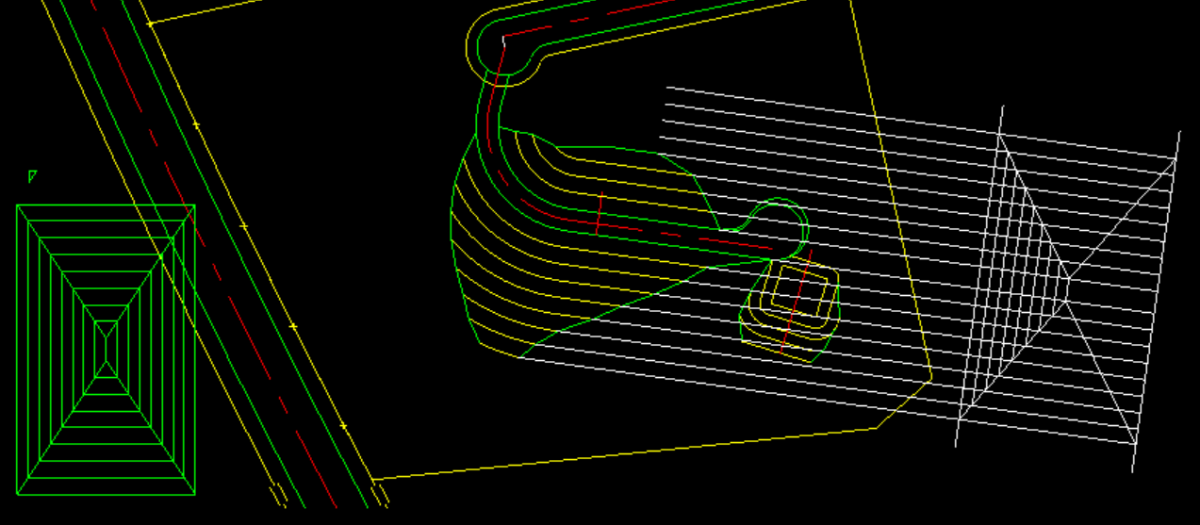

JonnaMcSki Posted March 9, 2022 Posted March 9, 2022 (edited) Is this also a Ratio Rectangle? I still don't understand, what that square is a copy of? Is that the road rotated? Edited March 9, 2022 by JonnaMcSki Quote
ReMark Posted March 9, 2022 Posted March 9, 2022 (edited) I believe the image directly above depicts the creation of the ratio rectangle which likewise appears as the second image I posted above. Edited March 9, 2022 by ReMark Quote

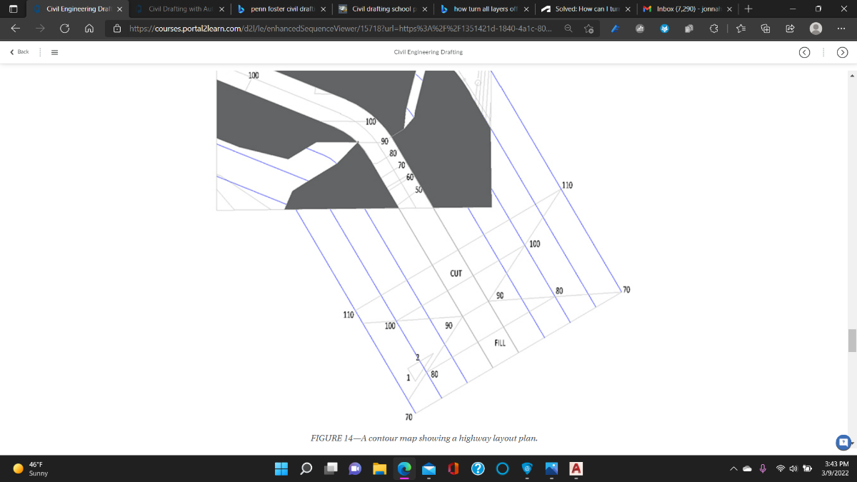

JonnaMcSki Posted March 9, 2022 Posted March 9, 2022 (edited) Maybe I'm not asking the right questions. let me try again. When fofa says.... On 9/7/2013 at 6:16 PM, fofa said: You also need to create a cut and fill layout ratio (the bottom rectangular portion of figure 22-48). The ratio “rectangle” can be created outside of the drawing area and copied/inserted into the lower left hand corner of drafting plate 2. Expand is this the picture we are referencing? Also, is the image we are taking about a copy of part of the driveway I just drew? If it is part of the road I just drew what part of the road it is the image (I mean the square) copied from? hopefully I'm making sense. Thank you for all of this. p.s. Goodnight/Good morning (depending on when you see this) Edited March 10, 2022 by JonnaMcSki Quote

JonnaMcSki Posted March 10, 2022 Posted March 10, 2022 I have seen others student's projects but I haven't seen anything that looks like that ratio on any of them. I can't even find something like that when I searched online. The only thing I've seen that looks like that is in the image I posted earlier. That is why I can't rap my brain around what it looks like, what info it is supposed to convey, what part of the driveway it is copied from, what it's use is, or what it is called. Quote

ReMark Posted March 10, 2022 Posted March 10, 2022 (edited) Did you not bother to look up the reference I provided in my previous post (re: Page 3, 17th post down)? This is how the Ratio Rectangle is created. I've outlined the first few steps, using white colored lines, the rest will be up to you. Note: the 3rd post down on this page shows exactly what the ratio rectangle looks like. Edited March 10, 2022 by ReMark Quote
