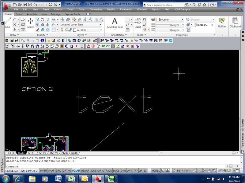

HeatherCee Posted March 31, 2011 Posted March 31, 2011 I am having issues with text size when I attempt to change the text size in MTEXT. It is set to copy the last size I used but when I need to edit the size, it multiplies what I enter by 8 and turns inches into feet. In other words, I try to resize 6" to 3". The text editor will then multiply 3" x 8 and size the text to 24 feet. Any ideas what's going on? Thanks! Quote
SLW210 Posted March 31, 2011 Posted March 31, 2011 What scale are you drawing? What units are you using? Is it actually making the text from 6" to 3" = 1/2 size you currently have? Can you post a screenshot or post a portion of the drawing? What is the height set in the Text Style? Quote
HeatherCee Posted March 31, 2011 Author Posted March 31, 2011 SLW210 said: What scale are you drawing? What units are you using? Is it actually making the text from 6" to 3" = 1/2 size you currently have? Can you post a screenshot or post a portion of the drawing? What is the height set in the Text Style? I am drawing at 1/8"=1'-0". I am using architectural units. It is not making the text from 6" to 3". It is making it from 6" to 24' when I type in 3" and hit "enter". The height in text style is set to 0. Does that make sense? I can post a screen shot, but I'm not sure what to capture since it's an action kind of thing. What would help the best? Thank you. Quote

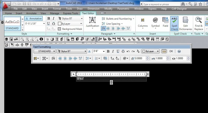

HeatherCee Posted March 31, 2011 Author Posted March 31, 2011 nestly said: I still can't reproduce your problem. Take a look at this video and tell me if I'm doing anything different. http://www.screencast.com/t/H3IQGj9hm The only thing that is different is that I'm not using the ribbon - I'm using the text editor that comes up over the text. A-like so. It does say "annotative" in the ribbon though...could that be it? I don't know how to change it that one...? Quote
nestly Posted March 31, 2011 Posted March 31, 2011 You have me stumped. The text isn't annotative, but it acts like it is. If it "was" annotative, it would be 1/16" tall at 1/8" = 1'-0" scale, but it's not, it's 6 inches. However if I make it annotative, it does become 1/16 tall, which is 6" in modelspace, and then changing it from 1/16" to 3" makes it 24' in modelspace, which I assume is the condition you're having. If it's just that one piece of text, delete it and re-create it, if it's all the text in your drawing, then I have no idea. Hopefully someone that uses Annotative objects on a regular basis will have an explanation. http://www.screencast.com/t/jat5cvWO Quote

nestly Posted March 31, 2011 Posted March 31, 2011 In your drawing, does the text show as being Annotative in the Properties palette? Quote
