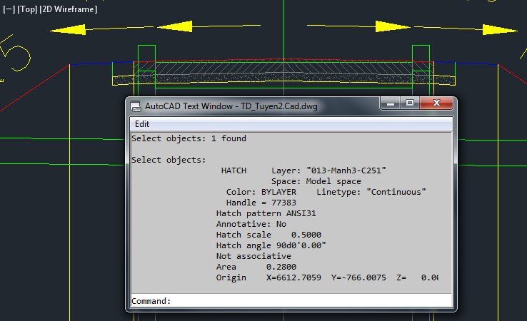

i have a prolem with hatch, some hatch pattern in previous cad when open in cad2012 auto convert to solid? any one can answer how to hatch be not change in cad2012.Thanks!::unsure:

In this drawing, hatch pattern in cross section are ANSI31, but when open in cad2012, those are SOLID. when u open online no prolem with hatch, this only happen when u open in cad2012.
I just downloaded and opened this drawing in both 2011 and 2012 and the ANSI31 hatch in the cross sections is still ANSI31.
but this is happen with me. i just open in cad2012 and do not anything.all setting in cad2012 are default original
Not sure why, although the origin coordinates (esp. Y axis) are different to those rkmcswain posted.
What happens if in 2011 (or an older version) you move the hatch to the origin 0,0, then save it as a copy and open it in AutoCad2012? Some hatches have display problems (concrete hatch for example) when they are situated large distances from drawing origin (such as what occurs when using real world coordinates).

That is a different problem. According to the OP's screenshot, the actual pattern is changing from ANSI31 to SOLID. It's not just a display issue.
See the screenshot below. This is the exact same hatch object that you have listed (compare the handle) - and it is ANSI31.
What I find strange is that our LIST windows are different.
Notice that in between the hatch pattern name and "Non-Associative", my window lists whether or not it is annotative, the hatch scale, and the hatch angle --- and yours does not....
What version of 2012 are you using? RC or the shipping version? English or another language?
i don't know what is RC version? i download iso file setup from internet and it's English version :lol: , so this is reason?
Is it a legal copy of AutoCad?
It's full version by crack. use XFORCE Keygen.
