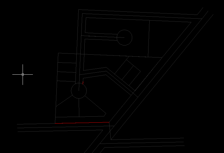

Batman Posted March 28, 2011 Posted March 28, 2011 (edited) I'm new to this site and I was wondering if someone could look over my drawing for my Penn Foster Oleson Village project and make sure I was on the right track. i have attached it here. By the way, this site has been a godsend for this project. I don't think I would have gotten this far without the info I found here. Thanks for doing what you do. Edited March 28, 2011 by Batman Quote

JD Mather Posted March 28, 2011 Posted March 28, 2011 Don't worry about posting edu dwg file. AutoCAD gives warning when opening and CANNOT POSSIBLY INFECT another user's work UNLESS they try to use your work as their own (which is their problem - not yours). So in general, there is absolutely nothing wrong with posting a edu file. However since this work is a common assignment it might be likely that someone WILL try to turn your work in as their own. Without looking very hard I found a couple of duplicate lines - not good practice. Quote
rkent Posted March 28, 2011 Posted March 28, 2011 Many times in the drawing you use three or four lines when one would do. Do not string lines end to end in a straight run, simply draw one line. Use the join command to make each of them one line. Do not draw on layer 0, everything I checked was on layer 0. If the lines in the center of the street were center lines then you need a layer for that with that linetype defined so they show as center lines. I don't know about the Oleson Village assignment so I can't comment on the project work you have shown. Quote
Car5858 Posted March 28, 2011 Posted March 28, 2011 Batman I think you need to re-read the instruction for setting up your drawing. The layers and colors represent different objects in the drawing. Always post screen shots, not the drawings, this will protect your work. Quote

Batman Posted March 28, 2011 Author Posted March 28, 2011 Sorry Everyone. This is new to me. I have deleted the file and have added a pdf of the drawing. I was actually instructed to draw everything on layer 0 and transfer it to the respective layers after. Not sure how to do that yet. Thanks for all the input. I have looked at all the info from this site. That's what got me this far. I was just looking for a quick overview to see if I was on the right track. Oleson Village work.pdf Quote

Batman Posted March 29, 2011 Author Posted March 29, 2011 I did set up my layers before starting. 14 of them. The instructions recomended drawing it on layer 0. They did say you could draw on each layer instead, but didn't recomend it. I have never worked with any Autocad before starting this certificate program, so I did what they recomended. Is there any recomended way to transfer info from one layer to another? Quote
JD Mather Posted March 29, 2011 Posted March 29, 2011 Is there any recomended way to transfer info from one layer to another? Crossing window and select entities and select desired layer. I prefer to get some of each layer that are easy with crossing window and then use Match Properties on the rest. (or use layers as you go - match properties is really quick) Quote

qball Posted March 30, 2011 Posted March 30, 2011 It seems the point of layers is to be able to hide / isolate certain layers to ease the drafting process. The paper print-out doesn't know what different layers are. And you can leave everything on 0 and just manipulate the linetypes and lineweights if that's all you're using layers for. Possibly the Penn-Foster instructions had other motives for the instruction, but I'm sure it's better practice to work within the layers. There's also some Lisp programs that switch to the proper layer for certain commands automatically (ie Text, Dimensions, Hatches) Quote
JD Mather Posted March 30, 2011 Posted March 30, 2011 I And you can leave everything on 0 and just manipulate the linetypes and lineweights if that's all you're using layers for. Uhmmm, doesn't that eliminate at least half my work? I certainly wouldn't submit myself to torture by manipulating on layer 0. Ouch! Set up a template once and done. Set it and forget it. Quote
Car5858 Posted March 31, 2011 Posted March 31, 2011 (edited) Possibly the Penn-Foster instructions had other motives for the instruction, but I'm sure it's better practice to work within the layers.There's also some Lisp programs that switch to the proper layer for certain commands automatically (ie Text, Dimensions, Hatches) This is true, The instructors will turn off all the layers except 0 and check to see if you left anything on layer 0. If by chance you did you will loose points. Make sure that the benchmark is in the correct location also. Do what JD, and qball stated, because it is easier to work on layers. You can turn off layers that you do not need. You will see what I mean in the next project. Edited March 31, 2011 by Car5858 sp Quote
